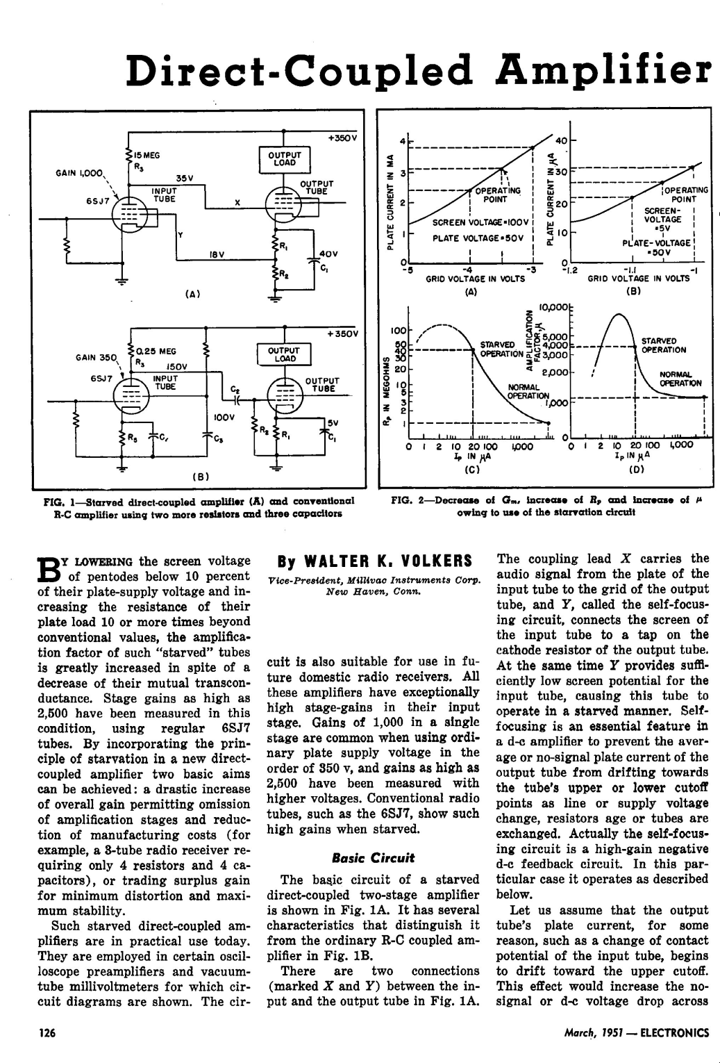

More "starved" than zero Va isn't possible, and yet can be useful:
https://www.radiomuseum.org/forum/tubes_operating_without_anode_supply.html
Long ago the major use was the starved pentode. It worked on the fact that the product S*(Ri par Rload) had a maximum at very low Ia so the voltage gain of a single pentode could be over 70 dB. This was more than high enough to compensate for the decreased Bw, via NFB IOW it could result in a simpler and cheaper design without sacrificing performance.
