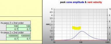

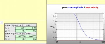

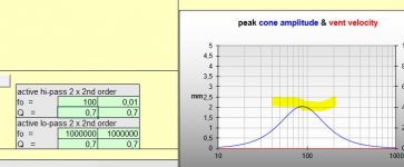

I am interested in a high pass filter that has a sharp cutoff at 100 Hz.
The reason is that i want theelement to have as low cone amplitudes as possible, not to 'disturb' higher frequencies.
I will have a (sub)bass element playing under 100 Hz.
I have used the ScanSpeak excel sheet that shows cone amplitude of a given element and boxsize. (5liter closed box 5.5 inch revelator.)
As you se from picture 1, the cone amplitude go down at approx. 12 dB/oct from 50 to 150 Hz.
A 12dB/oct filter only about straightens the curve so that 50Hz sine at same level gives the same curve amplitude as a 200Hz sine.
Picture 3 shows a 24dB/oct filter and it gets better, but still a 70Hz sine gives quite a large extra cone amplitude.
So I'm thinking 48dB/oct gets rid of most cone amplitude from spectre under 100 Hz.

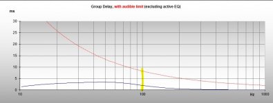

Scan speak suggests max 8 ms group delay at 100Hz, picture 4.
From: Toolbox – Scan-Speak A/S
The 2. order HP filter of the element and the box gives about 2 ms groupdelay, picture 4.
So I'm only left with 6 ms. Then 24db/oct and 6ms groupdelay is all I can "afford"
When I look at FFT of popular music I often see almost a 6db/oct slope from 50 to 150 Hz. So that leaves me with more low frequency cone amplitude than I like for real low THD at mid frequencies.
Yeah, it's a tradeoff unless the groupdelay can be avoided or I axcept more total delay.
