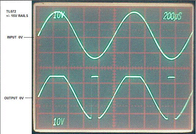

What is Common-mode input voltage range, VICR
Here is a scope shot of a TL072 as a Voltage follower with too much input. Top waveform is the input, bottom waveform is the output. When the input goes too low, the current source for the input JFETs is cutoff and the output slams the positive rail.
