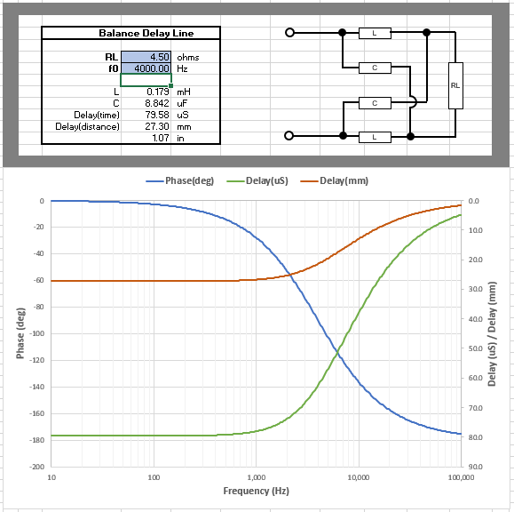

Back before all the fancy watch-as-you-twiddle crossover software was available, I found it useful to think of the all-pass nature of ladder networks in terms of delay rather than phase. Basically, you are electrically(rather than physically) offsetting the tweeter backward to match the acoustic center of the woofer. Using a single delay network, the amount of delay that can be achieved is tied to how high in frequency the delay is held constant. If you want more delay at a given frequency than a single network provides, you can cascade multiple networks as needed.
Attached is a spreadsheet you can use to get an idea of how much delay is possible and what component values to start with when optimizing your crossover. The input cells are highlighted in blue, where you enter the load resistance and the frequency for -90deg phase shift. An example screen shot is also attached showing values I used to move a tweeter backward by about 1.0” for a 1500Hz crossover.
Note that the ladder networks will only operate as ideal all-pass filters(ie change phase without changing magnitude) if the load impedance is constant and purely resistive. This is another reason you may need to tweak values from theoretical starting points.
  • ALLPASS_calc_v2.zip
    ALLPASS_calc_v2.zip

Getting delay for a given amount of msec requires more and more sections as frequency gets higher. Getting anything very signifant up to high frequency gets impractical pretty quickly. You can play with this in XSim pretty easily, it has a 'circuit block' for both first and second order all-pass, and you can cascade, and look at what it does in phase (that was actually the feature that XSim was originally made for). You MIGHT (but most likely won't without using some physical placement delay as well) be able to use passive at a lower cost than with a miniDSP. But only if you get it right the first time. With a DSP, you can get a number of milliseconds over the entire audio band and change it at will with no further cost, you can't get anywhere remotely near that using passive.
