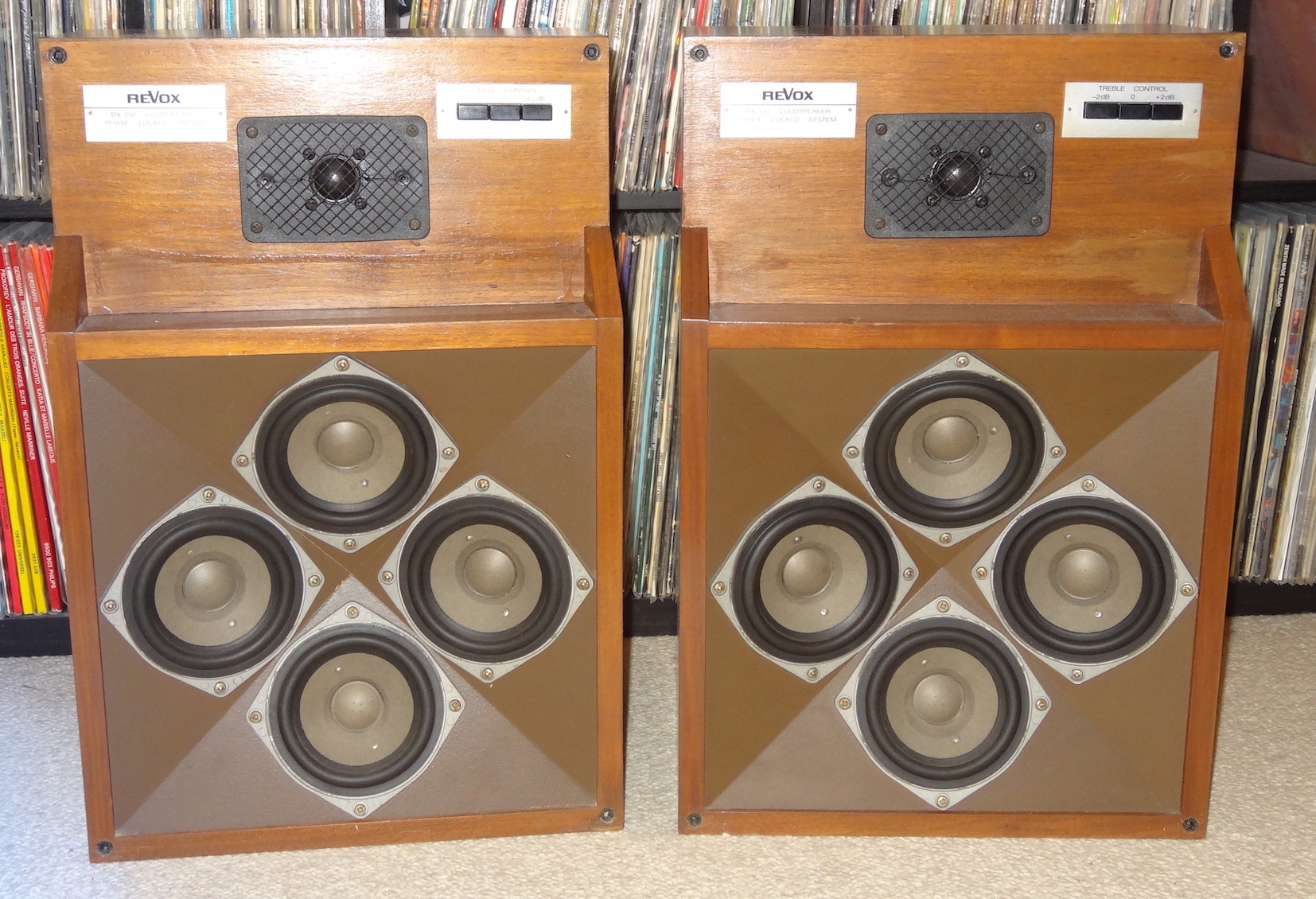

I am a big fan of the high end Technics speakers of the late 70's and JBL's so naturally these came up on my radar. What has me bugging y'all is that I wonder about the arrangement of these woofers. It looks an interesting way to mount four drivers.
I know with MTMs and the like that lobing and such can be problematic. Would that be a non issue because of the frequency these are crossed at? Or is it an issue and the reason why we don't see this anymore?

Nothing, as long as you cross them over low enough.
It all depends on what takes over from them.

center to center distance will limit how high you can reach with the arrangement
given they're 15" and there is around 2" between driver, that mean 17" distance
roughly 260hz shall be your upper limit. (1/3)

I did a bit of reading on that particular system :
Technics SB-9500の仕様 テクニクス
It turns out that:
- they are 35 cm woofers;
- only the upper pair are used all the way up to the (700 Hz) crossover point to the large horn;
- the bottom pair are used in a ".5" configuration as "helper" woofers for the lowest octaves only.
Clever 🙂

Oh wow... I tried to find info on them, interesting that they are .5 woofers on bottom. Its cool all the non conventional ways one can arrange drivers on a baffle. Am thinking about using a quad of 8" drivers for a speaker and the thought crossed my mind when reading someone else had done it and liked it. They never mentioned how whether they all played same though. I'll have to track them down and find out.

Having 4 or 2 woofer still create the C-t-C distance upper limit frequency (or live with a high Q dip)
To avoid the dip, only one shall play above ~250hz
Since I"m active, I'll be able to play the top one as independent (50-500) and the bottom 3 as 50-250hz.

JBL Everest 66000 (double 15" side by side) use one driver fully and the 2nd one is a helper below 250hz...
My current dual 15" is toed-in (both driver 50-500hz)
the toe in minimize the dip but the dip is still present.
I've started with single 15" and going dual was a significant subjective upgrade (DYNAMICS). Hope the quad 15" will prove as beneficial... If not, mid-bass horn it will be
