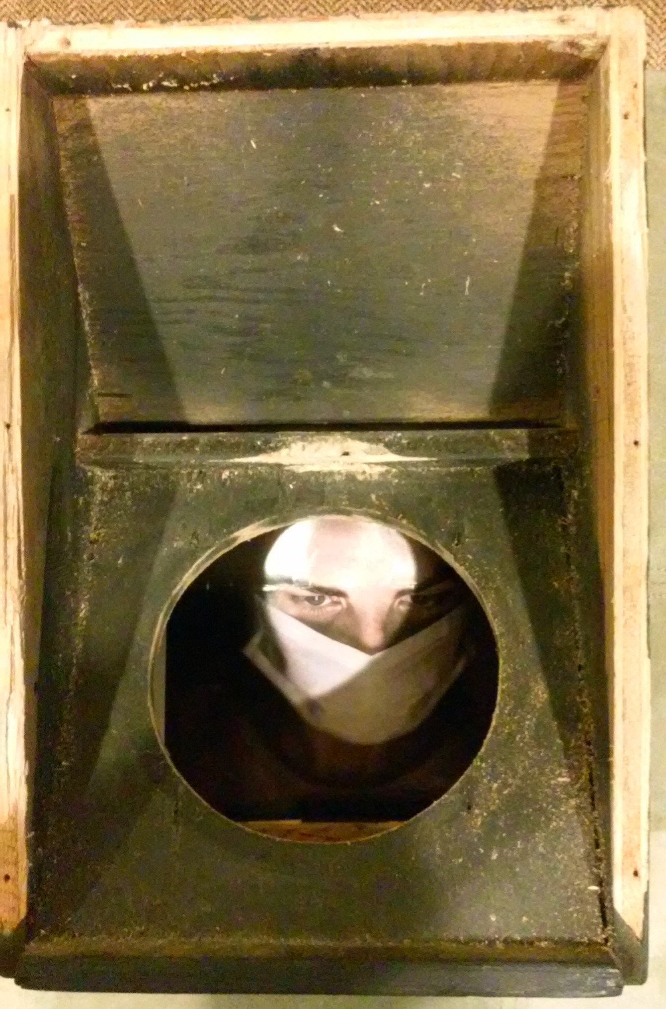

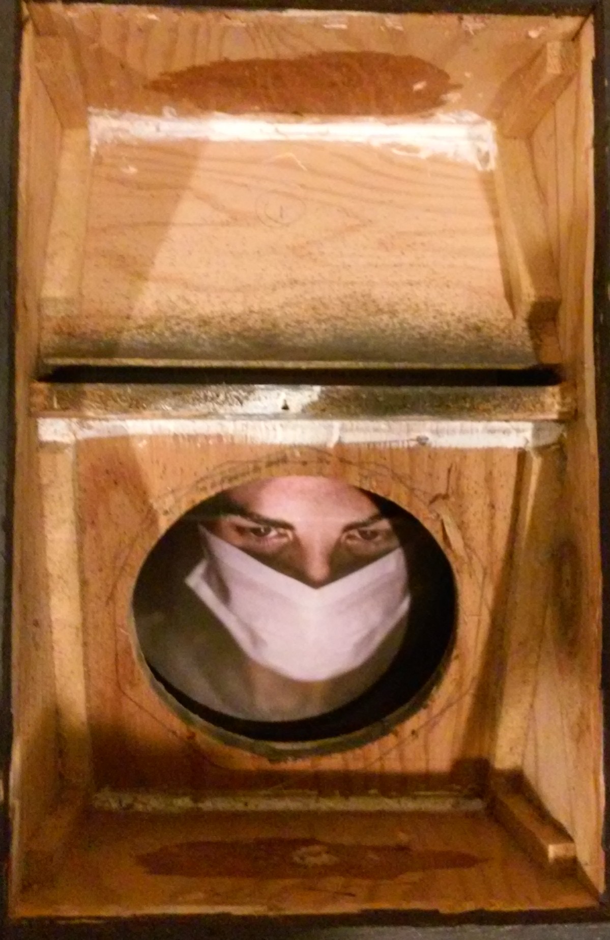

These are K5s that I scaled from original K12 plans (.42). I am now modifying them to accept PA-130s (not a direct fit due to magnet size) and foam core duct al la Xki but to original horizontal vent. I am also extending rear chamber by 3". If I don't like the result I can easily remove the foam core or K slot it.

Upon closer inspection I took liberties with my K5 build. One piece above the vent a la the Dutch K12 but with a horizontal vent and shelf. Also .42 scaling not applied to all dimensions. Plus now adding ducting to port and rear cavity extension. Soooo, not so traditional after all.
Demolition complete, wings removed and shelf edge relieved in center to accommodate front mounting of PA-130. Note horizontal vent above shelf and slanted upper chamber beginning at vent. Next I will extend depth of rear chamber by three inches ( I haven't decided about extending the shelf), add foam core duct to vent then sand and paint exterior. I'll post again after completion.
I have a packaged blue tooth amp on order to power them that XRK linked on another thread. It will be a lot neater than my naked "lunch money amp".

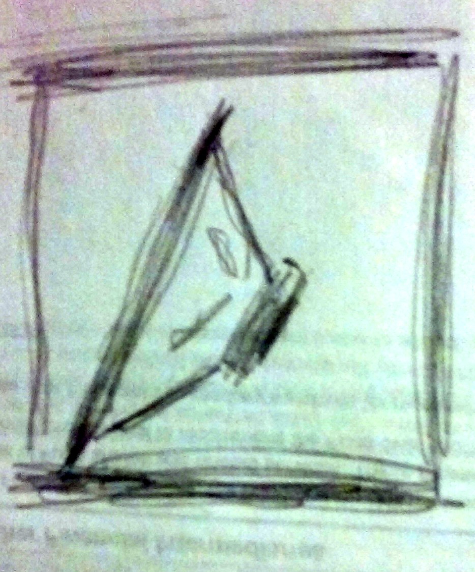

I had forgotten that my second venture into a K-box was based on a figure in a hard copy of a Karlson patent. It was driven by a 10" guitar speaker and would have been a natural for a smoothing stub. I don't remember what happened to it when I gave him the K15. I don't see that figure in the on-line patents.
We didn't really test it. It replaced a typical open backed cab with a Tiny Tiger (Poptronics Meyer) 20W amp in it. It really sounded good compared to the OB but had a better amp too, the Southwest Technical Products MMM 60W kit built amp. The guitar was the Harmony H19 Silhouette. Then when I completed my pair of K12s I gave him the K15 with the Phillips FR 12" replaced with a 12" guitar speaker. It sounded much better but was heavy to transport.
I may have that 10" speaker in a K12 that's stored in the garage. It's facing the wall with stuff stacked on top so I can't see the front.
He took the K15 to college and kids in the dorm came to see what kind of stereo system he had, only to find that it was a guitar amp with a portable radio driving it (no stereo). They were impressed by the K15 cab performance.

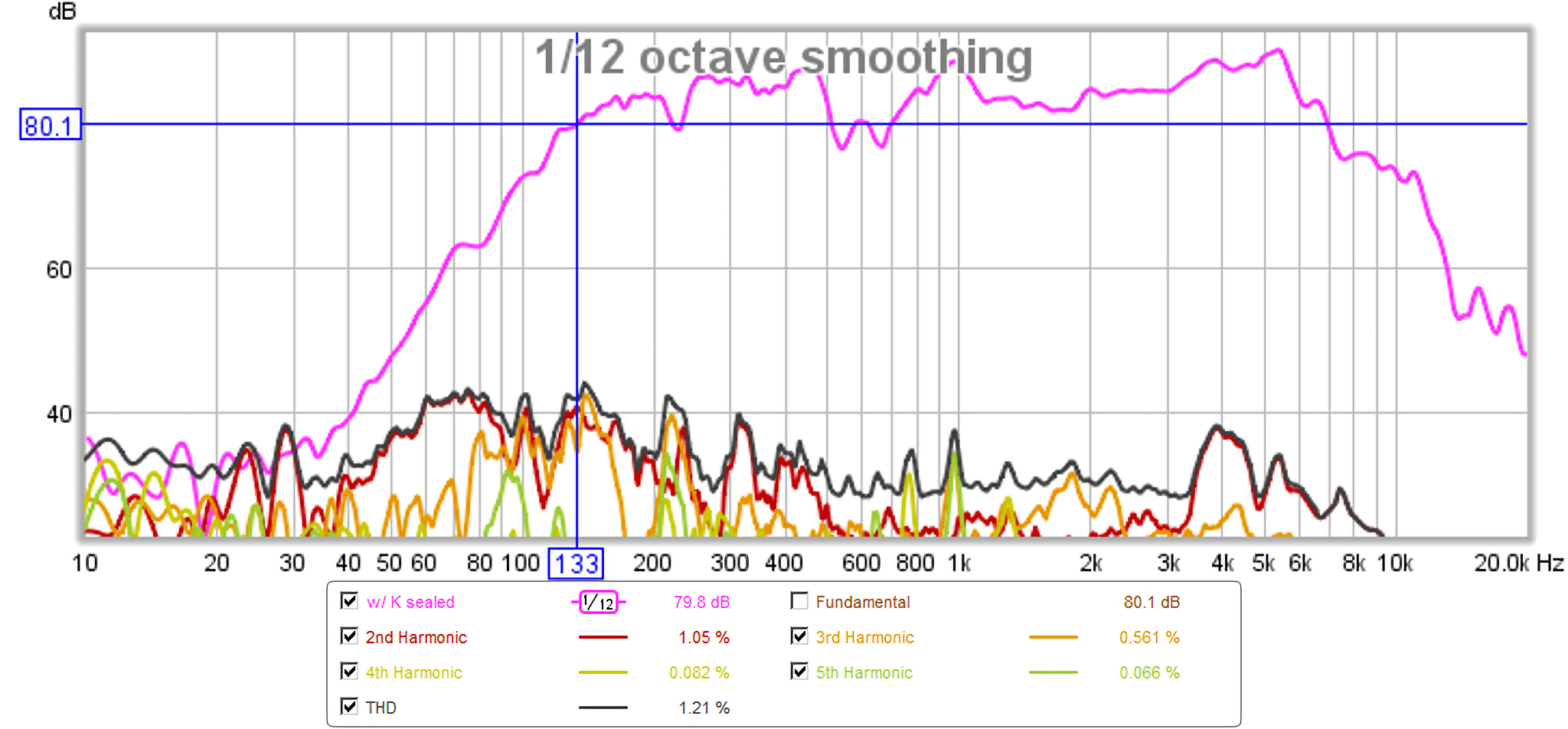

Here's an OEM Eminence 10 with 56oz magnet and qt ~0.25, mounted in a -.62 scale ("K10 size") K15.
It pretty well covers the bottom end of a regular electric guitar with E about 82Hz
(REW made a nicer looking graph)
