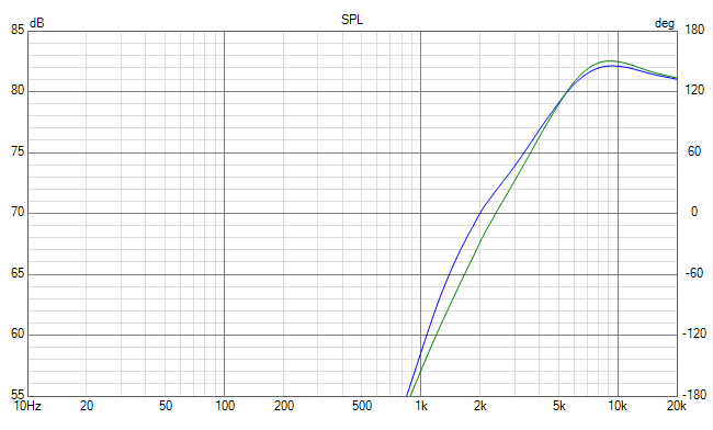

No. In any case, tweeter resonance is always driven.. even if generally at some lower level in the rolloff region. Of course if you cross first order within the octave of resonance then you won't get too much useful output. There are better ways to use a 1" dome.1 Can or will damage be expected provided it receives low voltage and not overdriven in excess

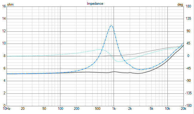

Impedance sweep.4 Can the resonant frequency of any driver be found without parameters ie frequency sweep multimeter
Just insert a series resistor (around 1k) for the frequency sweep, and the resonant frequency will be evident.Impedance sweep.

A tweeter can be used down around its resonance if you apply a parallel LCR trap right at Fs. The problem is Fs can change with temperature and break in, so its important to run the driver for a while and then measure Fs to calculate the LCR impedance notch. The other issue is power handling and driver xmax, usually making it a pointless exercise. I always use an LCR notch if the tweeter will be run on a first order HP.
When you drive a driver at Fs two things happen.
The first is that efficiency goes up. Back EMF causes impedance to rise. When input voltage remains constant and excursion too, this amounts to more output for a given power input.
The second is that the origin of distortion product shifts from the electrical to the suspension side. In the region outside the resonance region, cone movement is largely determined by current flowing through the voice coil. So any distortion here, like Bl modulation, will have a relatively large impact. At resonance, much of the motion is determined by inertia of the moving mass versus mechanical storage in the spring system formed by the suspension, counteracted by breaking forces. So any non linearities here will determine distortion in cone movements.
Since it is even more difficult to reduce non-linearities on the mechanical side than on the electrical side, all drivers I know show increasing distortion going towards resonance.
