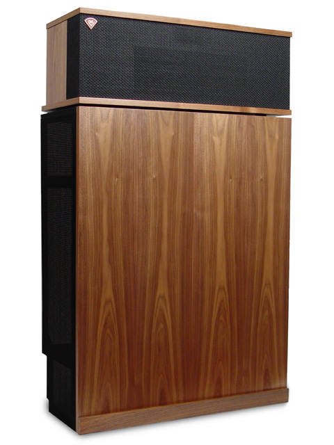

Nice illustration! This begins to show why small rooms are so acoustically difficult with their nearby surfaces and tendancy to multiply image sources. The wider a speaker's dispersion, the more damage is done to the direct-to-reflected energy ratio. This is why physically large speakers, especially front horns, can often perform better in corners than can mini-monitors. The higher directivity minimizes extraneous reflections in the midrange and treble.
