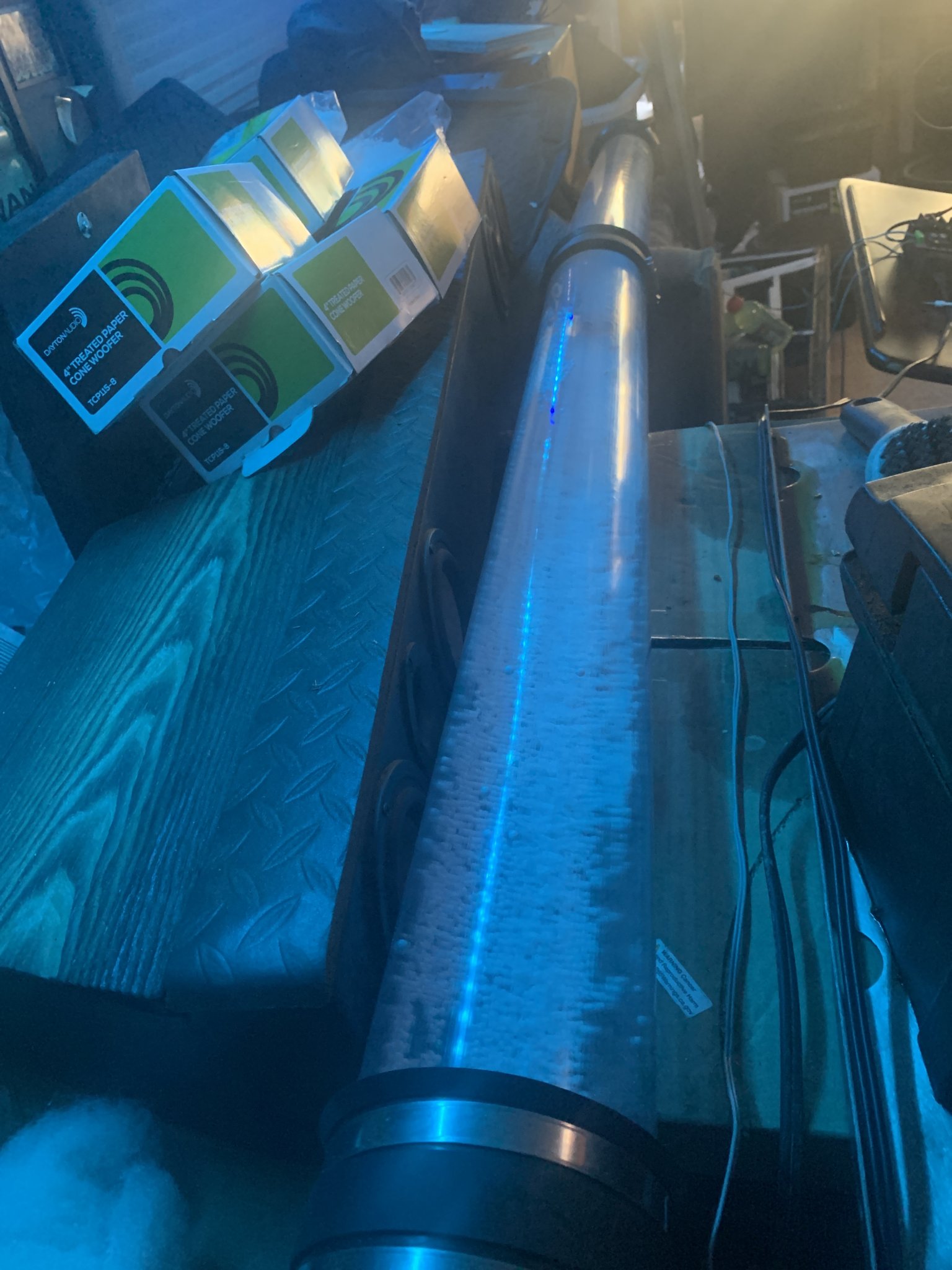

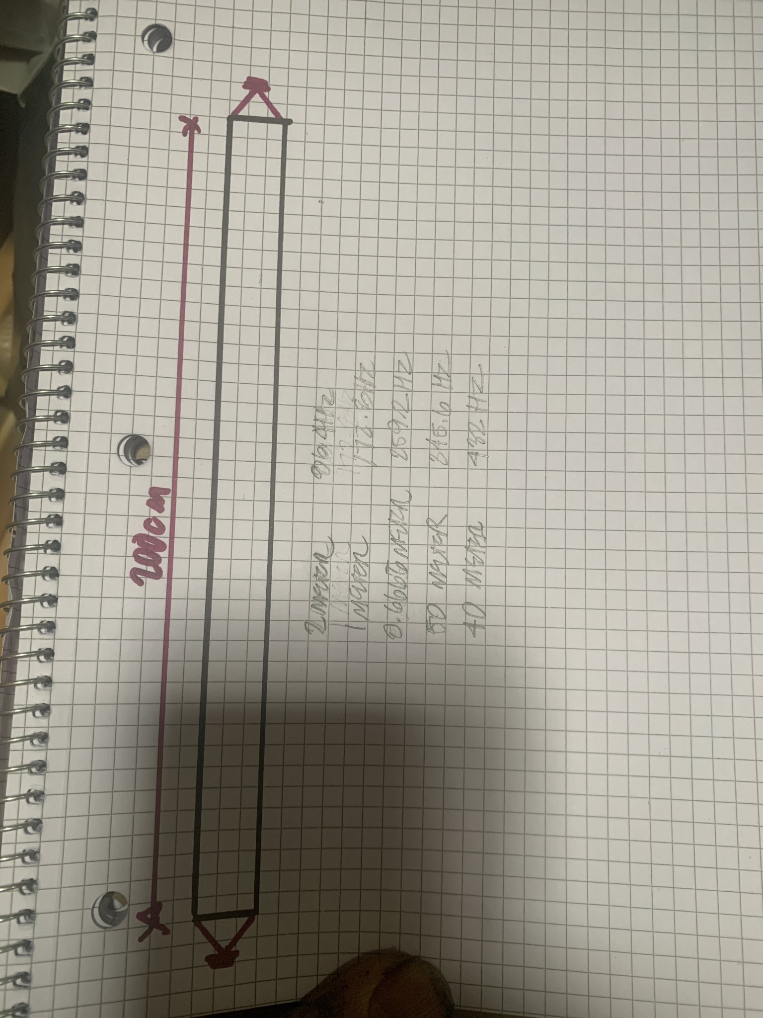

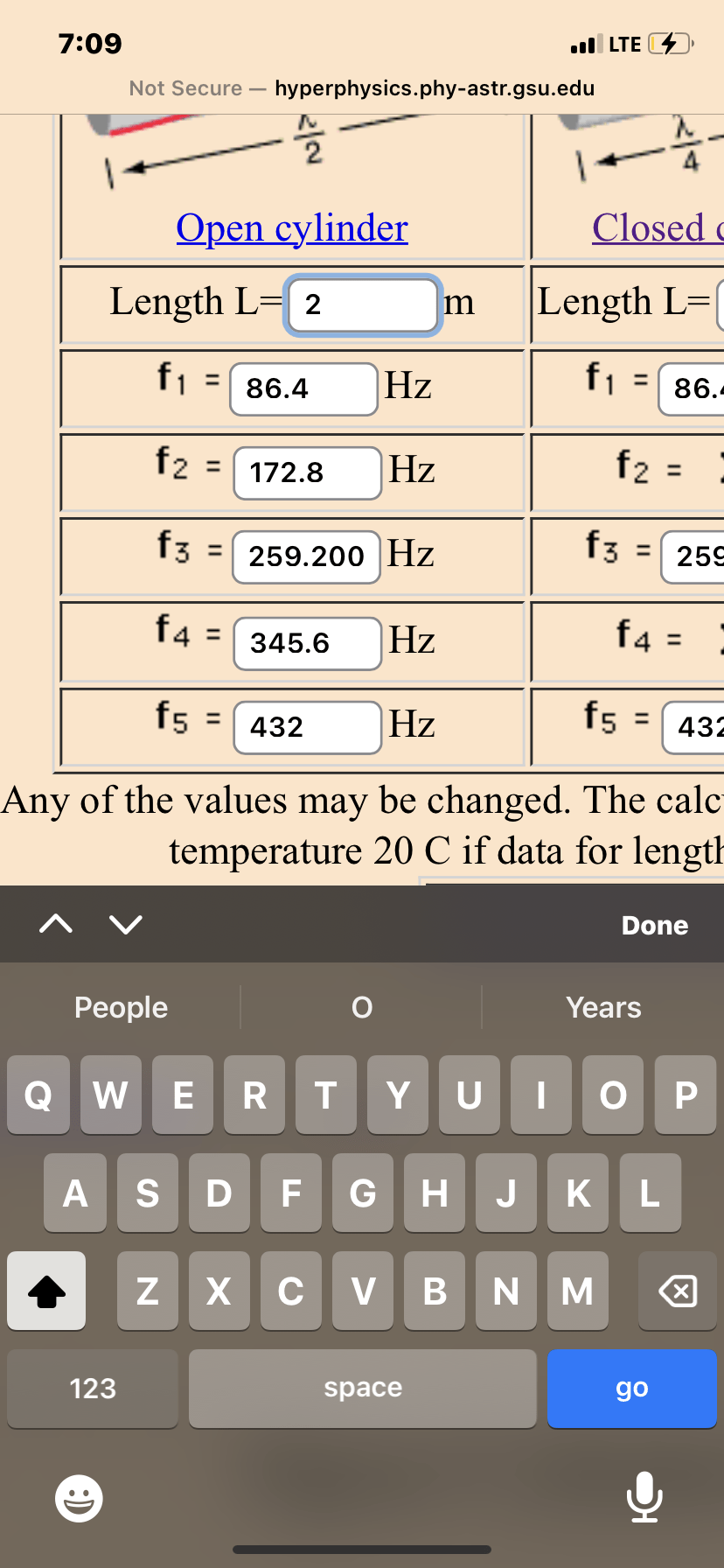

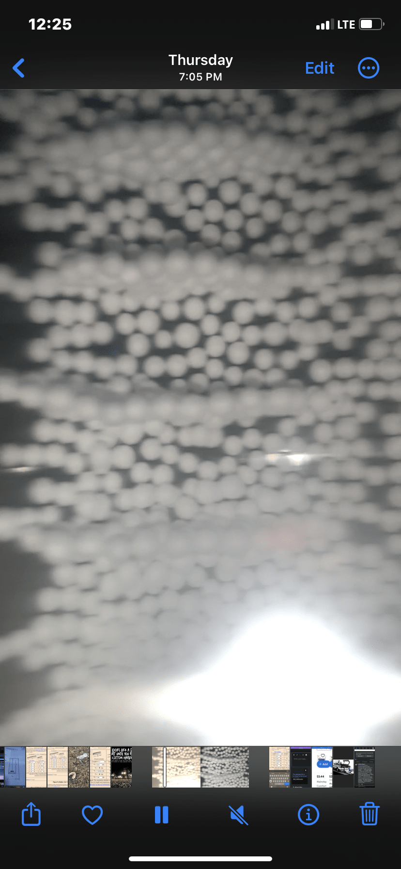

I built a sealed kundt tube 200 cm long with drivers on each end to ‘see’ AND hear resonance, etc..

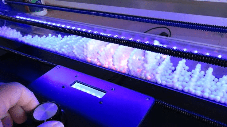

. It goes nuts at 172.8hz and forms these shapes.. (the video is super cool looking in slow motion!) the other freqs dont (Barely) form any shape ? What’s up with 86.4, it doesn’t form the ‘stripe shapes’ within the sine wave formations of gathered vibrating styrofoam beads?

Kundt's tube - traditionally, you would have a driver at one end of the tube and the other end closed.
By the "stripe shapes", I presume you are referring to the "walls" or "striations" formed by the styrofoam balls.
Their formation appears to have something to do with the "acoustic streaming" mentioned in Wikipedia: https://en.wikipedia.org/wiki/Kundt's_tube
Apparently, the additional transverse stripes form in the antinodes, caused by the circulation of air between the wall of the tube and the tube axis.

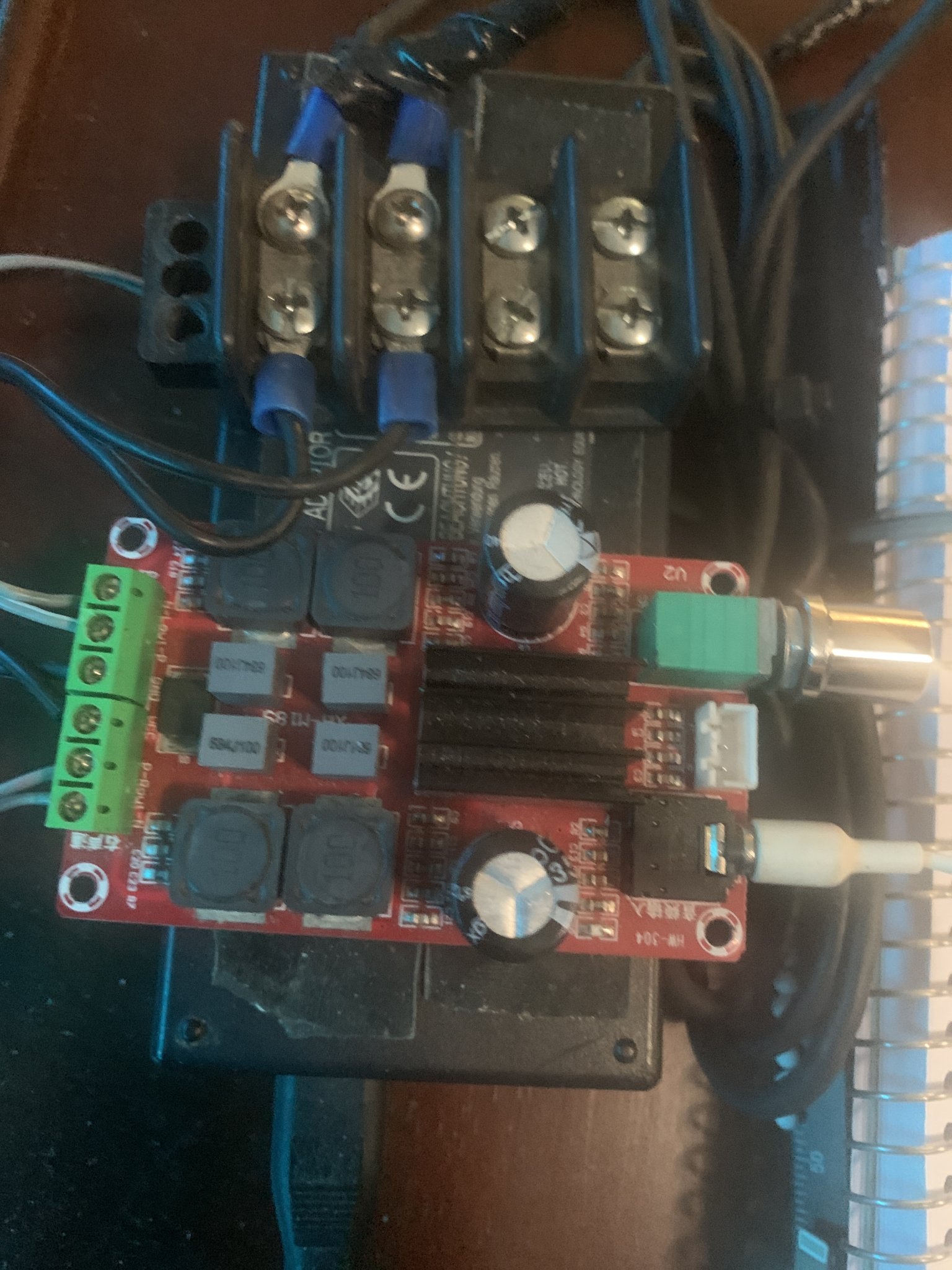

Thank you Galu😀🙏🏻. I should change to the 4 ohm version of the driver to get more output to stir up the other resonances
