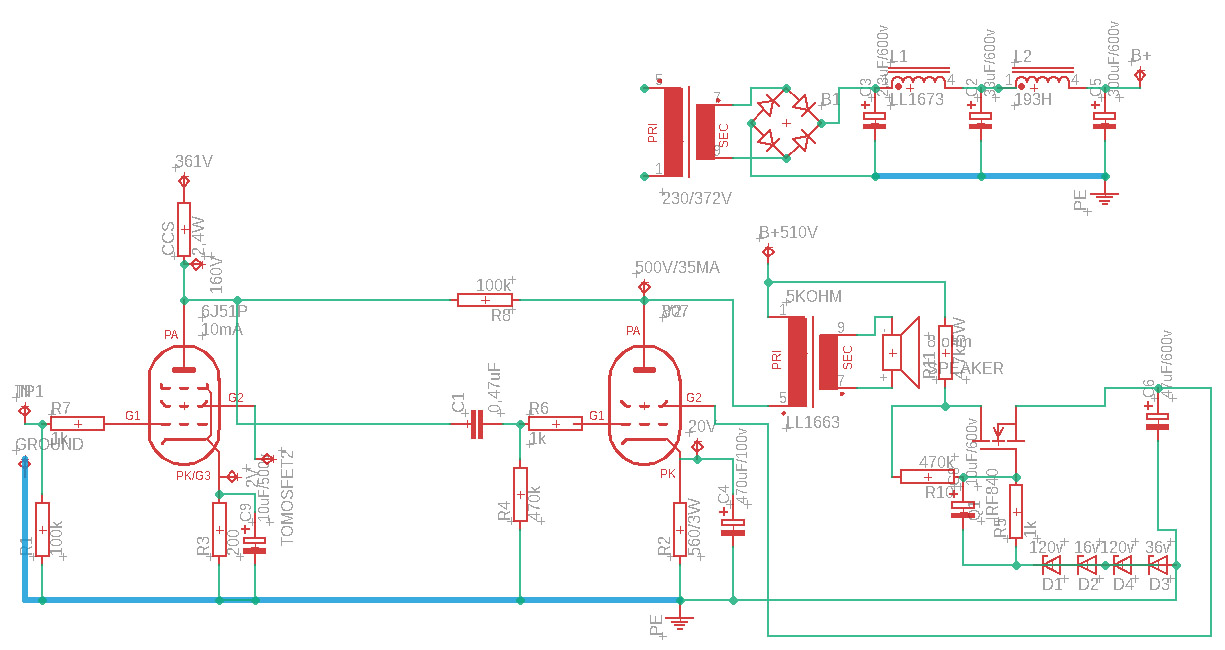

Do you mean screen ( g2) voltage ?It is a 807 se amp the gridvoltage should be300v,I have 350v.
Can I use that?

Draw the schematic with voltages, including cathode, control grid, screen grid, and plate, as well as the B+ filters and resistors.
Are you using fixed bias?
What is the control grid voltage?
Are you using self bias?
What is the cathode voltage?
Is there a resistor that drops B+ voltage to the screen?
What is the B+ voltage at that end of the resistor?
What is the resistance of the resistor?

Here it is basicly.
I have zeners so it should give around 300v,but it accidently run hot once at now it gives 350v.
Maybe I could use a resistor between The mosfet and the grid. 🙂
might be a simple saver for the tube.
I have today tested with a resistor between The mosfet and Grid 2 so that I have 280v.
Is that close enough or should I go higher?
If sound is acceptable then it seems to be a good solution.I have today tested with a resistor between The mosfet and Grid 2 so that I have 280v.
Weakaning the screen supply will compress the (plate) negative periods,
my guess is that it will increase 2'nd somewhat. But if it's audiable i don't know.
