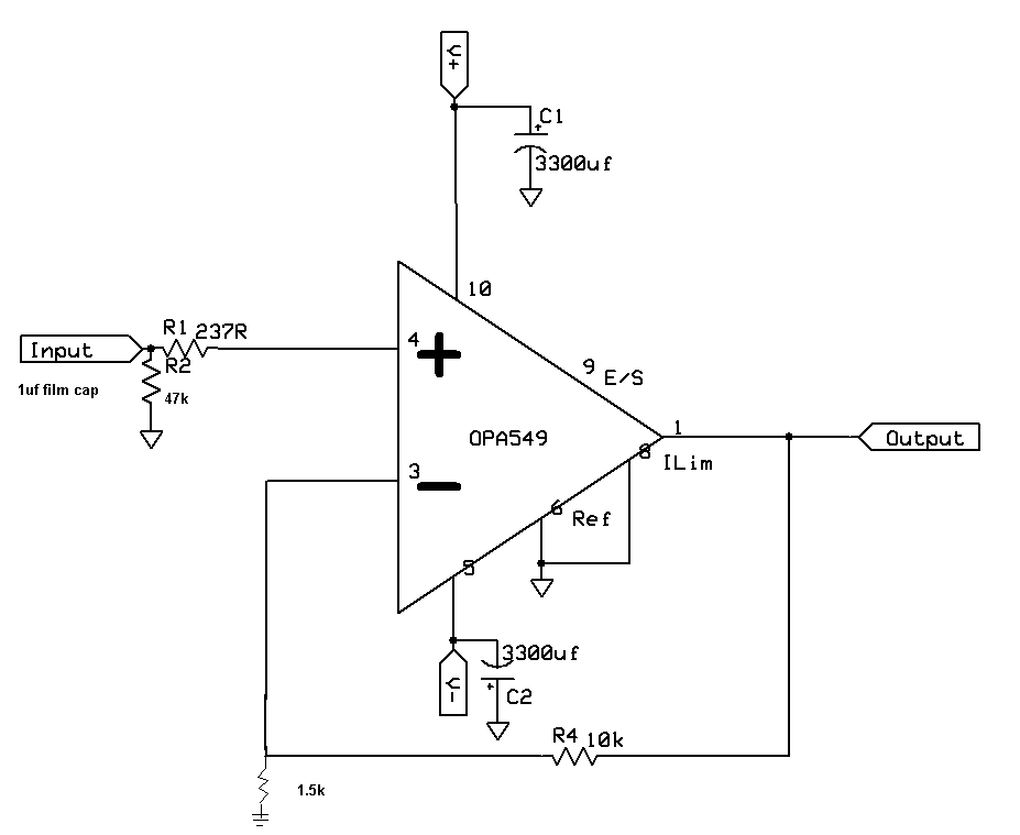

What is the RC time constant of the high pass filter on the input?
What other RCs inside the amplifier could affect the LF frequency response of the amplifier?

As usual, Andrew makes a good point. Check the input impedance and figure out the corner frequency to see if you are affecting the bass.

I have the following circuit...
http://www.diyaudio.com/forums/atta...6-my-opa549-schematic-does-look-ok-opa549.gif
Andrew which rc time constant are you talking about? input cap and R2?
