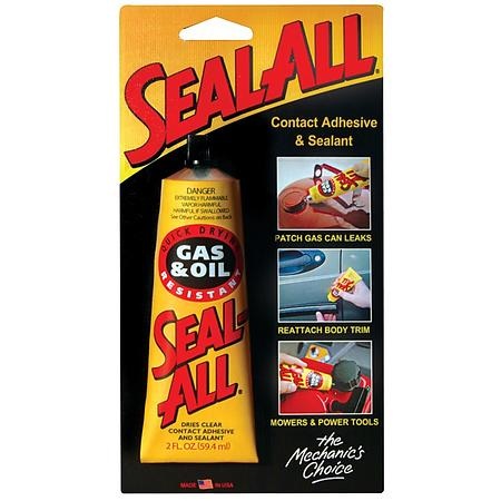

When the dust cap on one of a pair of Energy Connoisseur C-2's I had came off (out of warranty) I called (the old)* Energy co and they told me use "Seal All" which is a fairly high VOC sealant in a tube. Very common in automotive shops because it's impervious to gas and oil when cured, so should not be hard to find. A bit tricky to work with but with some careful positioning it worked and it's been 10 years since. Poly cone speaker.
