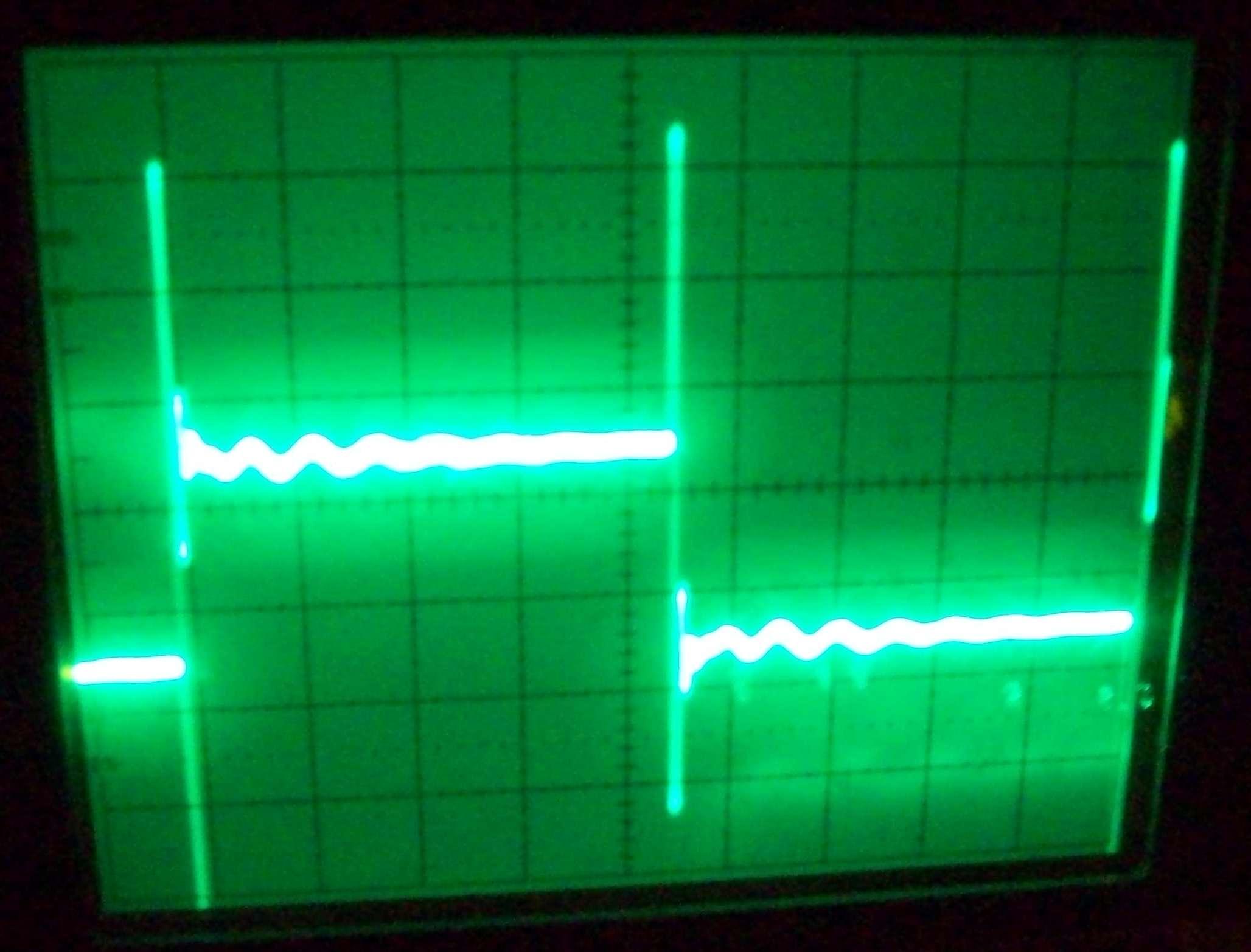

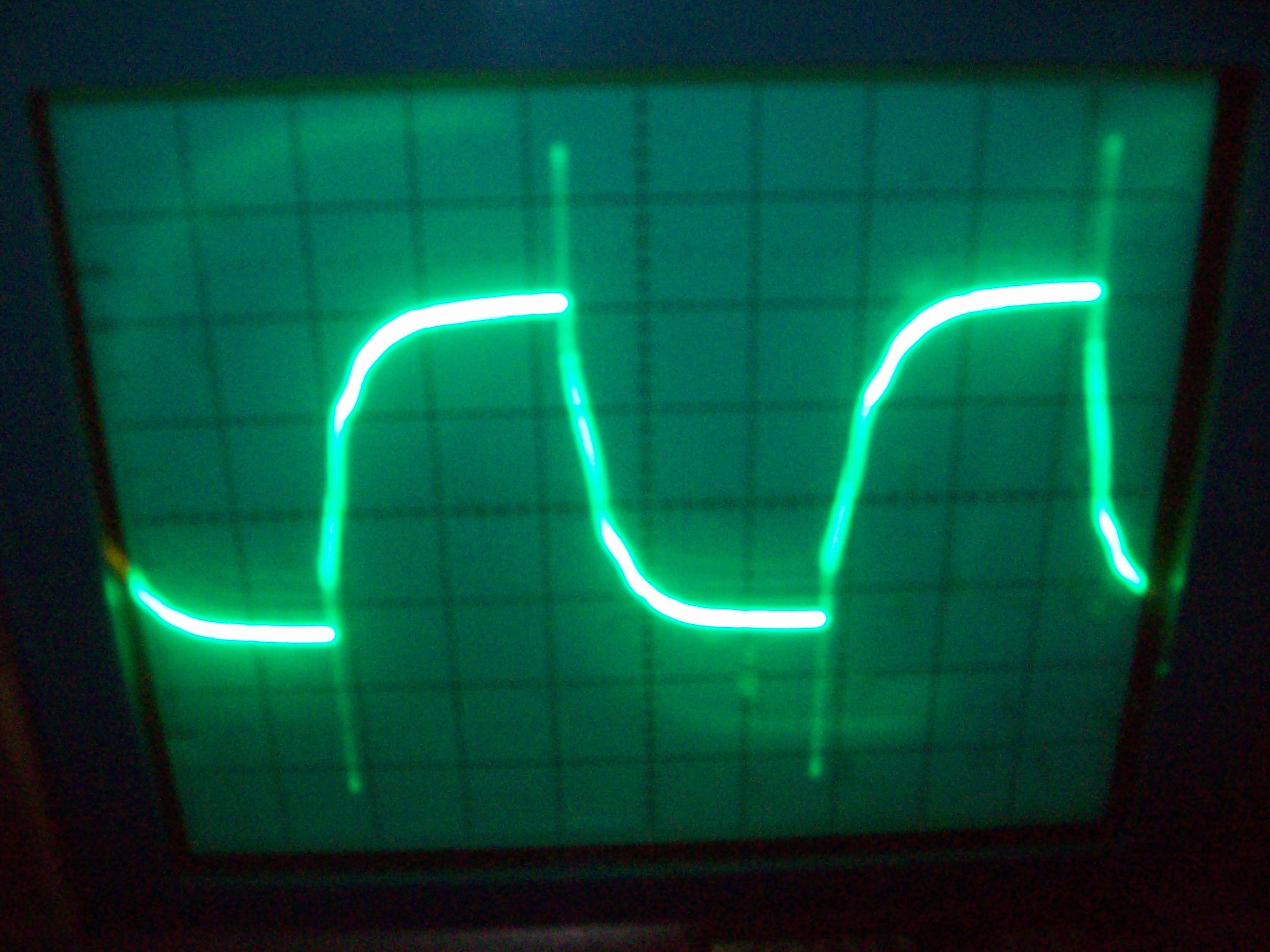

Here are two square wave traces from an output transformer that is 6K6 to 8/16
Both are at 10K, the one with the visible ringing is from the 8 Ohm tap unloaded the second is with an 8 ohm resistor across the 8 ohm secondary. I’ve seen the rolled off front edge before but what is the spike at the back side? While I am on the subject, can anyone point me to a good tutorial on interpreting square wave response? Please excuse the picture quality😱

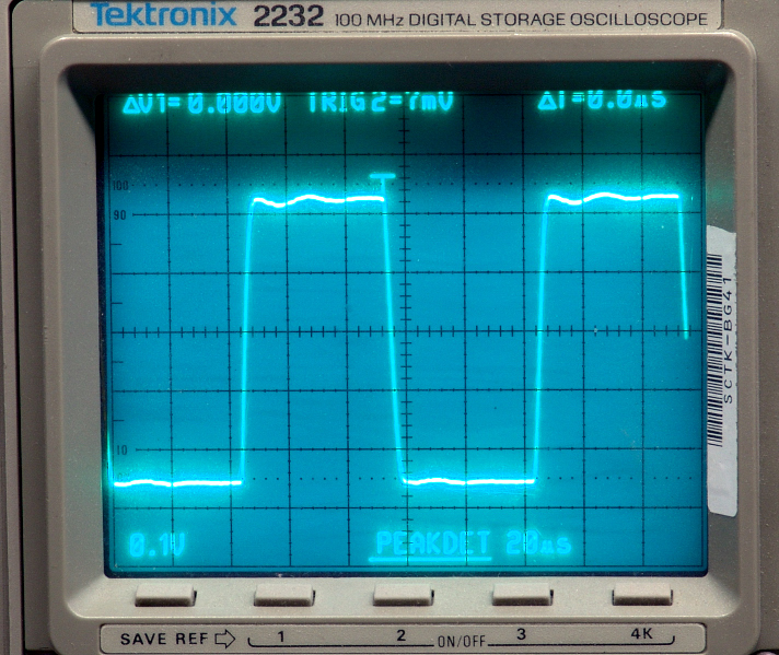

The photo shows a 10KHz square wave at 1 watt through a Simple P-P using some OPT's that I paid $16 for. The OPT's were designed for guitar amps and use no interleaving whatsoever. The transformers were made by Schumaker using the same technology applied to their battery chargers.
Spikes like those are an indication of some really high frequency energy. That didn't come through the OPT. I would suspect some interaction between the scope and the circuit. Do you have one end of the secondary grounded? Is this measured in an amplifier? If so, do not run the amp unloaded. As mentioned it can lead to damage in most tube amps.

Thanks for all of the replies
Just for clarification, I was testing the transformer itself not a whole amp. There was only 10vrms on the primary from a 600 ohm source. My main goal was to find the turns ratio with a sine wave which was easy enough. I was more or less messing around when I switched to square waves and saw the weird spikes at high frequencies.
I believe that the primary cause is the leakage inductance for this transformer which maybe be a bit high. This means that the coupling in between the windings is not that good or the turns distribution in between layers has not been maximized. To measure the leakage inductance, you will need to short all other windings then with an LCR meter, measure the inductance of the concerned winding.

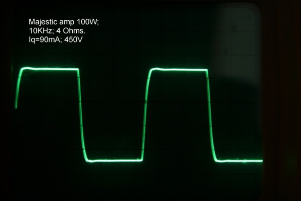

It doesn't correlate with Fourier analysis. With global NFB, the old rule was a transformer reproducing a 10Khz square wave should see
minimal 3rd harmonic attenuation at 30Khz. So a transformer with good response at 20Khz should imply a droop not less than -3dB down at 60Khz.
So in p-p tube amps using global nfb, the 5th harmonic is already very low and I ignore this. The result is then an amplifier design based on 3rd harmonic and the enclosed is a 10Khz square wave pic of high power p-p 100W amp at rated o/p. The response of transformer (E&I) was specified by the maker as -3dB at 70Khz which for it's size is a very well designed balanced component and the resonant frequency at approx 100Khz. The final amp response was trimmed at 55Khz by both combination of trimming the Bode plots of the 1st stage and the capacitor on the 20dB global nfb loop.
The result is fully optimised.
Too low source impedance !
Use stated load at secondary and a source impedance equal to the reflected load at primary.
So, use a 8 ohms load and a 6K resistor in serie with your .6K source.

Yes, I think you are right. From the little I know I would expect the low source impedance to cause problems. I don’t know how much I could tell about the transformer testing it at such a low level anyway. I was more curious about the spikes which I had not seen before. I have never tested high level transformers only small signal stuff and I am careful to use driving and loading impedances that match my intended application.

The square wave from the generator looks fine none of the spikes or ringing.

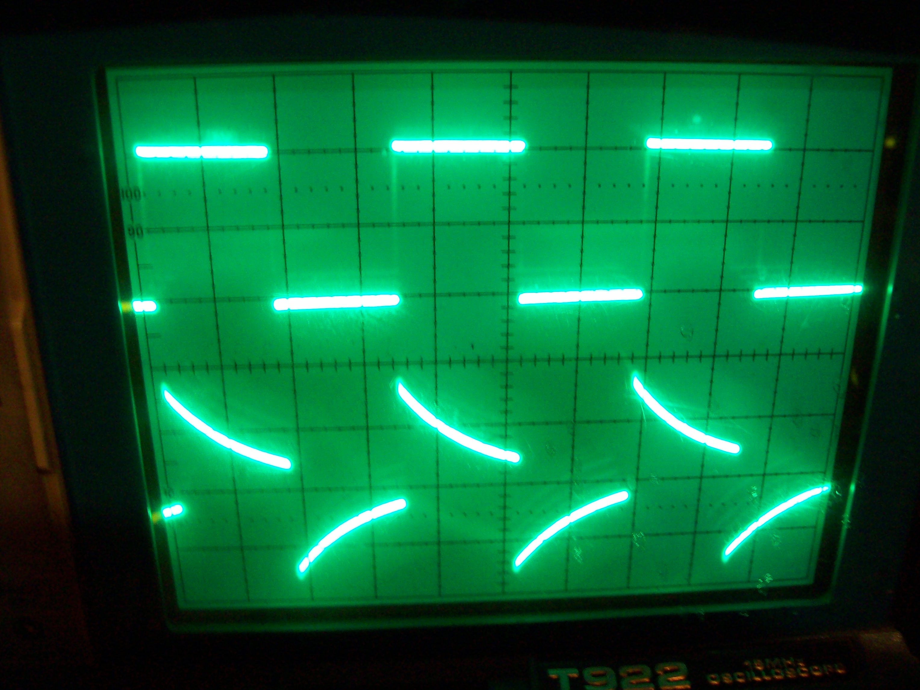

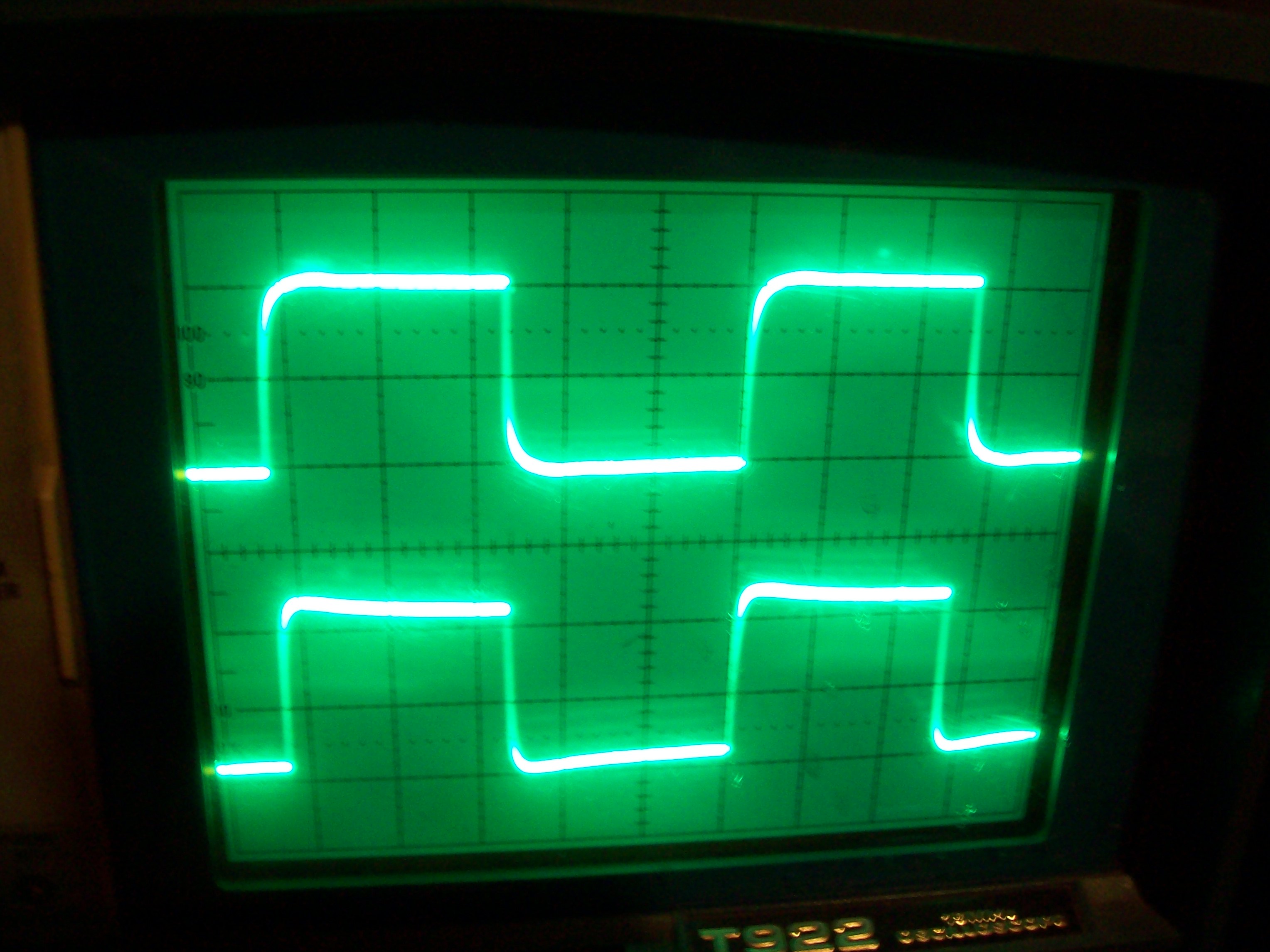

More shots for the curious. This time I added 820 ohm resistors in series with both legs of the primary and an 8 ohm resistor across the secondary. Top trace is the primary and bottom trace is the secondary. The hf shot is at 20K this time and the lf trace is 100 Hz. The phase shift you see in the lf trace was not there when the primary was driven directly from the 600 ohm source.
