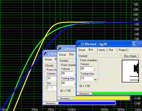

Few days ago i've get pair of Visaton BG20 and because i can't afford any other speaker i want to ask What type of Loudspeaker box will i made ? I don't know many of acoustic rules and if you have any idea or plans for this i will be gratefull !!!
In the market when i get this BG20 told me that he is ok for bass-reflex or voigt pipe or TL, but i don't know which type of enclosure ?! and i don't know how to make it because i don't have any plans?
Importand is that i will use only one of BG20 in every of the loudspeakers, and the size of box is not problem for me

Looks to me it will fit most high efficiency full range designs for
8" units out there, e.g. for the fostex Fe208 and similar drivers.
IMO you should should investigate baffle step compensation,
a parallel inductor and resistor and then add a capacitor in
parallel to bring the high treble back.
Some standard box info : sealed, reflex and over-damped reflex :
🙂 sreten.

I did some sims using published specs awhile back and got the best tradeoff between eff/BW in a straight ML-TL. Like any ~max flat alignment speaker, it may need baffle step compensation, and with this driver, some form of EQ to tame the mids 'shout'/drooping HF response as already noted.
All dims are inside:
L = 26.93"
w = 16.91"
d = 10.43"
driver down 12.5" from top
3" dia x 1.75" long vent near/at bottom - make longer if a more rolled off response is desired.
19mm 13ply Baltic Birch or Appleply material preferred.
Minimal stuffing, just enough to keep reflections from coming back through the cone.
I recommend making the cab long enough to get the driver up to ear height and fill the extra bottom cavity with Kitty Litter, cement, sterile sand, or equal to mass load the cab and use this tweak to mass load the driver: http://melhuish.org/audio/images/press-screw.gif
If you decide to build it, let us know what you think, and what, if anything you did differently to improve it, etc..
HTH,
GM
