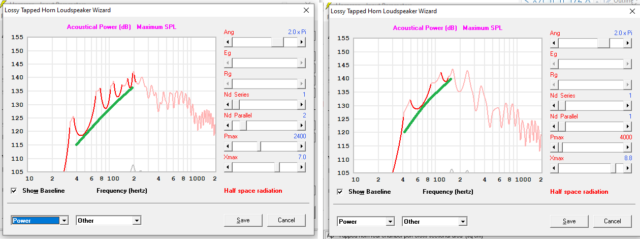

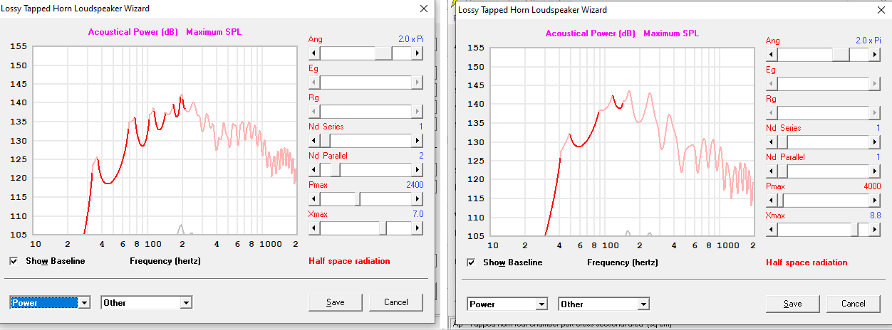

Hi there,
This was touched on in another thread, and I've also read the Hornresp Help file on this. But I'm afraid I can't quite understand exactly what is being presented and why.
The understanding I have so far indicates that it shows the maximum SPL against frequency that my design is capable of, and what is limting it from going any further.
So as far as I can tell, either the realistic maximum SPL is a line that follows the troughs (low SPL points).. Or that at the maximum wattage and Xmax, the response shape that is shown occurs, because of the various and uneven limitations.
Also, do I need to know about amp current and voltages to effectively use the tool? So far I've been using what I know, which is driver rms/program or peak wattage and Xmax.
I've attached an image of two competing design's Max SPL windows. Could you describe how they compare- particularly what SPL each design is capable of reaching, and why this is so.
Thank you

The Max.SPL tool shows how loud the speaker will get at each frequency, given the limits you've entered. ie, a maximum SPL will be reached when either the driver runs out of excursion, or the maximum power input has been reached.
I tend not to use the "maximum power" option, because the input power is heavily dependent on impedance. ie, if the speaker's impedance goes from 4ohm to 20ohm, then the applied voltage (in order to maintain a consistent power input: P=(V^2)/R ) will vary hugely. PA amps are voltage sources, which apply a voltage and allow current to flow.
As a result, I use a combination of maximum voltage (based on my intended amplifiers) and excursion.
Looking at your graphs, when we apply a protective highpass filter and look at the limitations within the passband, I'd say the first design will hit 118dB, and the second about 128dB, assuming your amplifier is capable of getting the drivers there. At some frequencies, the speakers will get louder than those numbers, but that's a guaranteed "they'll hit that SPL at any frequency in the passband" rating, which is something I'd prefer.
You might find this useful: https://www.prosoundweb.com/spec-wars-looking-inside-loudspeaker-spl-specifications/
I wrote it out of frustration at the games the marketing departments play in the PA world.
Chris

Based on what you are saying, I've drawn a green line on the graphs which is what I'm guessing is what horn resp is indicating is the maximum SPL my design can generate, before it runs into limitations.
Am I correct?
Thank you

Ah, I see now how you came up with the 118 and 128dB readings. You've read the bottom most (lowest frequency) amplifier power limitation.
As far as I can tell, usually what is quoted is either a mean point accross the usable bandwidth of the speaker (in this case I'd say 128 and 132 respectively -I am using approximately 40 - 140hz of the graphs). But most often just a peak figure, with varying degrees of relevance, depending on how honest the maufacturer is willing to be. In that case I think we are looking at something like 133dB @ 130hz and 138dB @ 120hz.
But I'm guessing if you were looking at this from a Hifi/Home Theatre perspective, the low end of the response is what you'd home in on. I didn't say, these two are for live sound reinforcement.. And 100-140hz is very relevant.

It'll almost certainly be excursion rather than amp power limited in those dips, but yes, you've got where Chris is coming from - take the lowest in-band dip as the number to keep in mind.
The thing is, if you take the 128dB figure from the 90Hz region in pic 1, and size your rig based on that, what happens when you get program material with strong 40-50Hz content?
Either it simply won't go anywhere near 128dB, as we already know (if it's a really good well behaved driver), or it'll get somewhere close but with extreme amounts of distortion from pushing the driver well past Xmax if it's any other driver.
Neither does you any favours as a PA operator, hence the preference for assessing the design based on more of a worst case scenario.
HTH,
David.

The dark red sections are excursion limited, and yes, that's how I read the maximum output of your cabinets.Ah, I see now how you came up with the 118 and 128dB readings. You've read the bottom most (lowest frequency) amplifier power limitation.
If you haven't already, scroll back up and read the article I wrote. It details the ways manufacturers cheat with their numbers, often by a large amount.
I can say that, from my own experience, there's a pretty serious difference between something that's -3dB at 55Hz, and -3dB at 38Hz. The PA subs I design are flat-to-40Hz, as I find that's the best compromise between output and extension in portable applications.
I believe my explanation of Hornresp's Max.SPL should be sufficient, but please post up if you have any questions.
Chris

I guess my next question would be if there is any way of reducing the limitation caused by too little excursion?
I’ve tried reducing the size of the throat. That works, but in the process messes up the frequency response.
Might restricting the size of the baffle cut out work? IE only cutting out half the circle, and leaving some material (though obviously not enough such that the cone fouls the ply at high excursion).

There are always frequencies where the excursion is minimal but unless by chance you played the speaker at that exact frequency tone for an extended period the cone will still be moving & cooling the voice coil.
I agree with the comment on the High pass for a Tapped horn. Usually this can be lower than you would expect.
The main reason for tuning for a 40Hz + rather than lower is to increase the efficiency and reduce the size of the cabinet. Those extra bottom Hz come at a price.

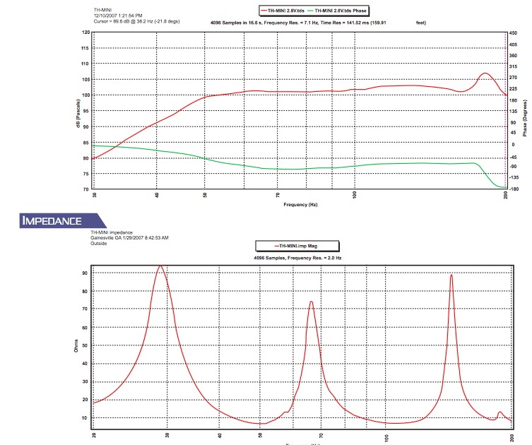

I suspect the optimal response from a single type of subwoofer (a sub that covers both the infra range and the ‘kick bass’ range) is probably about -3 @38hz (for bass reflex).
So for my purposes doing small gigs, a Th-mini, for example, would do the job fine.
As is evident from it's impedance curve, the DSL TH-MINI has an Fb around 50Hz, and like a typical bass-reflex, it's response drops at around 24dB per octave below Fb, excursion increasing rapidly as the driver "unloads" and impedance rises.
It's response is around -12 at 38Hz, and can't be equalized flat that low without running out of excursion at relatively low output, though the larger TH does provide around +3dB gain over a smaller bass reflex cabinet with the same Fb.
