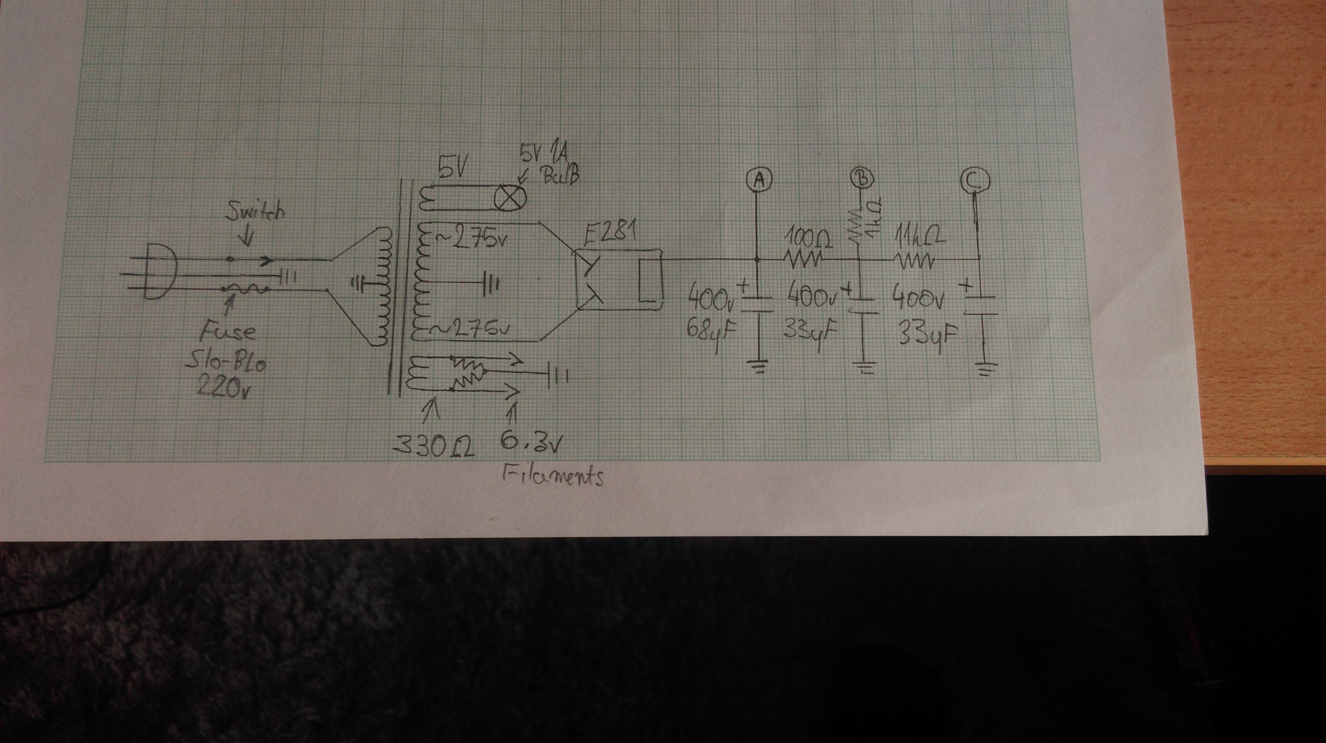

Where can I find cheap power transformers for EZ81?
First I want to say hi to all and I am new to the forum...
Thank you all in forward for replying to this!
Sorry for starting this again but I have some trouble finding transformers for the tube amps... (common problem because there are only a few companies manufacturing them).
I live in a poor family and i cannot afford everything I want... Plus i live in middle of nowhere on Balkans (Europe).
So if you have any knowledge of some good(and cheap) transformers please post it.

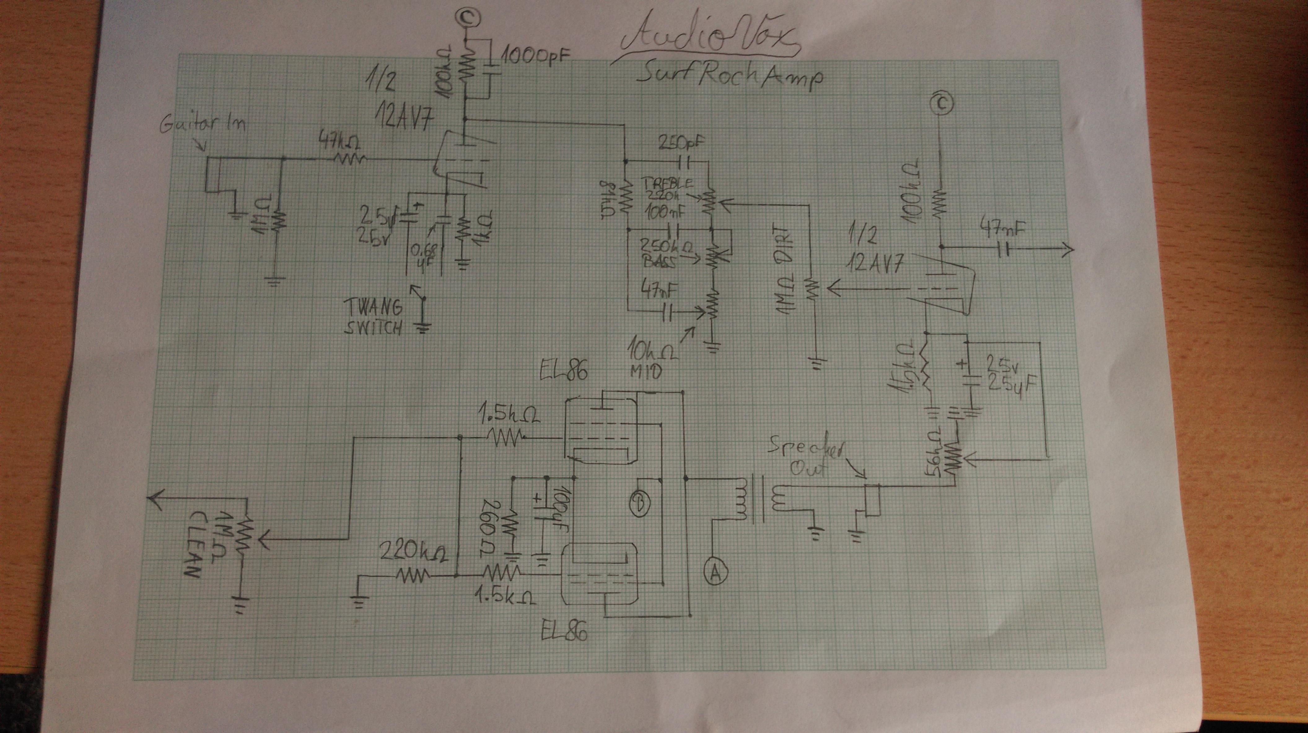

Hi all, I hope you can have a look at this schematic that I designed and what do you think could be changed... This is an SSE (Dual Single Ended) power tube section that may can confuse others but it is just like a Push and Pull with a less power... The schematic was designed by me, but i took designs from all over the amp world... Little bit of Fender, Vox, and Magnatone.
Thank you in forward for replying!
Remove the 1nF cap across the anode load of the first stage and replace it with 470pF and 4k7 (in series).
Your NFB goes no where. place a 180R resistor at the top end of the cathode load and feed the NFB to the cathode. Watch out for a zero ohm potential across the NFB pot, may cause issues, place a 4k7 in series.
Otherwise it is a modified standard Fender but watch out for the anode voltage on the EL86s, they can't stand as much as an EL84.

Perhaps I'm confused. Is the amp you refer to in this thread as SSE the same "Surf Rock Amp" amp that you posted a schematic for over on the Instruments forum?
http://www.diyaudio.com/forums/instruments-amps/309342-what-do-you-think-about-tube-schematic.html
I thought your designation of SSE must stand for Stereo Single Ended and that this thread was about building a stereo amp, not a guitar amp.
The schematic you posted on the Instruments forum is typically referred to as PSE, Parallel Single Ended, since the output tubes are connected in parallel.
So, if you could clarify it would be helpful and you would likely get advise that is more useful to you.

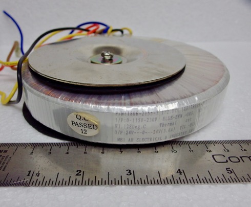

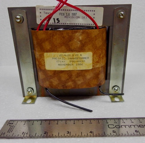

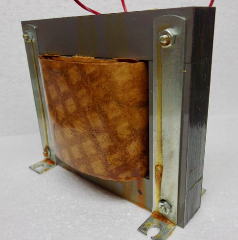

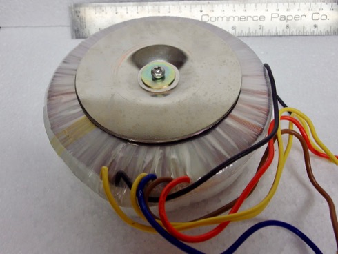

I just took this transformer from a working SCS power amp , would it help ?
It weighs 10 pounds. The amp had a treble oscillation issue
Also a torriodal from a working Samson Servo 160 power amp that had a Sanyo power chip failure
