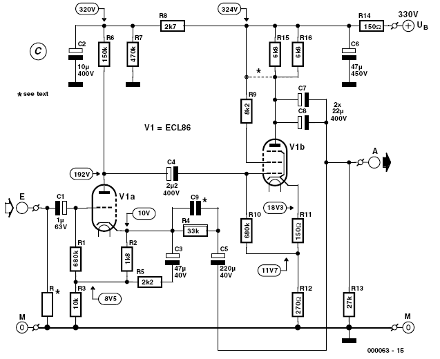

I wonder whether the author ever actually tried his shown pentode option. It's got a major flaw, I think.
SY said:I wonder whether the author ever actually tried his shown pentode option. It's got a major flaw, I think.
Are you referring to the fact that if you connect that dotted connection you'll short the output to ground? 😉
Yup. And if you don't, the screen isn't bypassed properly to the cathode.
BTW, the Heretical will not warm up the sound.
I think that you may be missing the point with the dotted connection.
It is an alternative to connecting the screen grid to the Ht.
If the grid is connected via the dotted line, and not to the HT, you have a triode.
Hope that this helps.
by the way the diagram is from Rainier Zur Linde's book, which I have lying around here somewhere.
kind regards
bill

Nobody seems worried about the exorbitantly high interstage and output coupling capacitors, forcing the use of electrolytics, which in the case of the interstage will probably have enough leakage current to influence the pentode working point.
2.2uF for the interstage and 44uF for the output coupling if I read correctly?!!
To take you to a -3dB cut-off at a low 5Hz interstage would need only 33NF, and likewise for the output, of 1uF. And that is without taking the further extending action of the feedback into account (I have just done a hurried calculation without determining how much feedback is left at say <20Hz.)
One does not always want to sound "wiser-than-thou", but I always wonder why when using feedback to get the RIAA characteristic, the designer does not also make use of an excellent opportunity to build in a low-cut attenuating characteristic below say 20 Hz. It calls for just about no extra components, and a cut-off of 16 - 20 dB/octave can easily be obtained. No turntable is perfectly rumble-free, there are also possibility of bumps that can dislodge the speaker cone, etc. (Rumble-wise, it makes no sense to me to pay several $100 extra for what can be achieved by $5 components.)
I have used 3 such designs in the past with great acceptance (one designed to replace the 1st stage in the Quad II control unit), but must hang my head in shame for not being able to post the circuits right now - PC problems. There have been a host of excellent circuits here in the past so I hesitate, but should there be any interest I will be happy to post them as soon as possible (in about a week). They respectively use an ECC83, ECC81 and ECF80 each, with different gains.
So being unable to "deliver" now, I would at least suggest that you cut down on those unnecessarily high capacitors if you want to use this circuit. Get within the region of available polyesters for several reasons.
Regards
Sorry folks (following),
I saw the circuit as an RIAA equaliser since C9 was not specified. On re-examination I have doubts since I do not notice the equivalent de-emphasis above 2.2 KHz. Otherwise my remarks stand.
