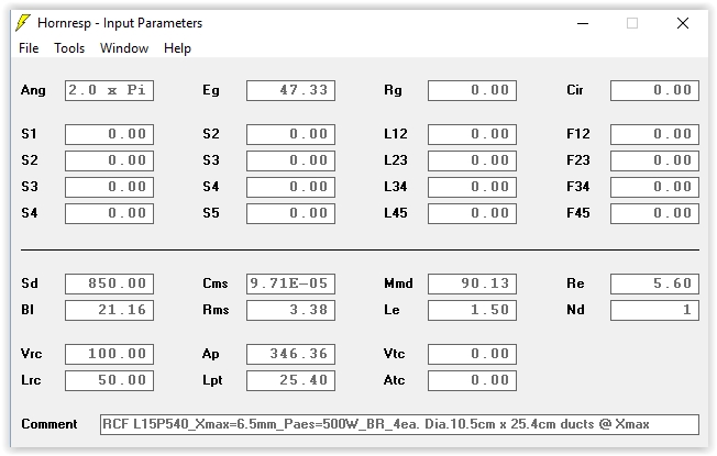

I'll attach a quick simulation using Hornresp w/ 4ea. 10.5cm Dia. ducts. That might help as it also reduces the Vnet a little bit.

I basically agree w/ Post #18 by conanski, with the exception of the available upper frequency range; that could easily be increased depending on you system requirements. Most definitely use a high-pass filter. I'll attach a simulated filtered bandpass response from the Hornresp simulation posted in Post #12.
