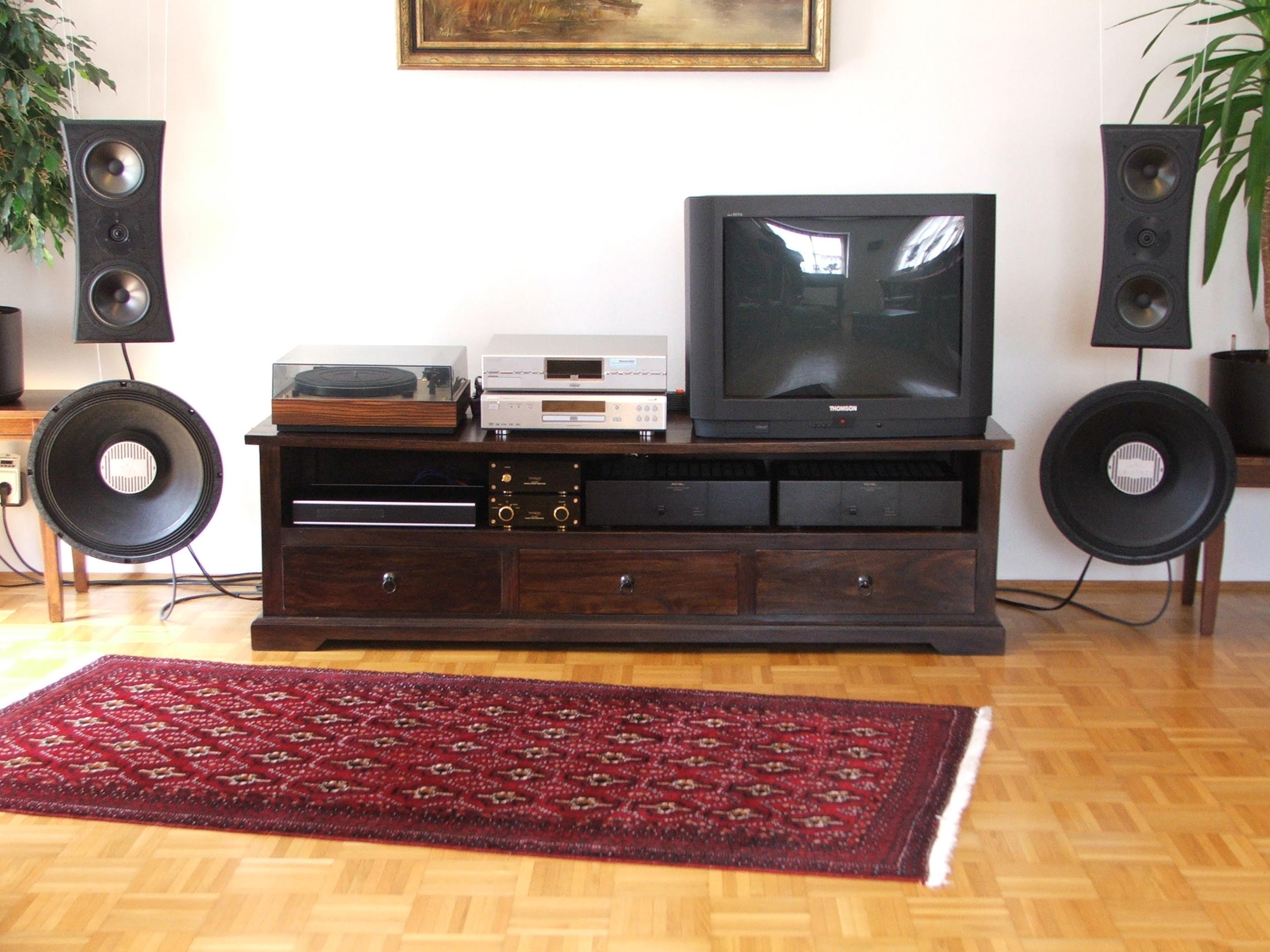

I am really fond of speakers like the Kyron Audio Kronos or the ones from Reflector Audio.
I want to use my bass drivers that I already have since I like how they sound and perform, these are FaitalPRO 15pr-400. I made a design where both drivers are as close together as possible, thinking of a crossover around 120hz or so to give the full rangers some relief at the bottom end.
BUT now the BIG question, what will happen with this set up? I really dig the look and everything, but will the 15" movement closely behind the full range driver cause distortion? It is firing straight into it, ofcourse the full ranger will move approx. the same but has a cutoff where the FaitalPRO steps in.
Total disaster?? or will this be ok to try?
The frame connecting the two will be laser cut from 5mm stainless steel. As for the legs I have to figure out a nice way that is at a reasonable price...

But you wouldn't expect distortion in the full ranger due to the big woofer right behind it?

Let's say you can do anything imaginable in DSP. What would happen if you mixed in a little bit of the woofer signal out of phase into the FR - just enough to cancel whatever air-coupled "push" it's going to get from the woof, being in that position?
Flip the phase of the FR and run it FR? With a little high pass at whatever frequency the woof-coupling is no longer efficient? So what if the tympany doesnt make a wideband rarefaction? The design and stand looks cool!

Not only will low frequencies move the mid cone, which is bad, no matter how you look at it, but you will have another problem, just like in your other speakers, mismatch efficiencies, and even if you go active, woofer will run out of steam, and will bottom out due to cancellation...long sentence, sorry

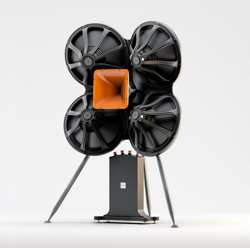

I have seen speaker somewhere, where mid/tweet horn is in the middle, and four woofers open baffle are around
Can't find it right now
I think you mean the one I post underneath.
