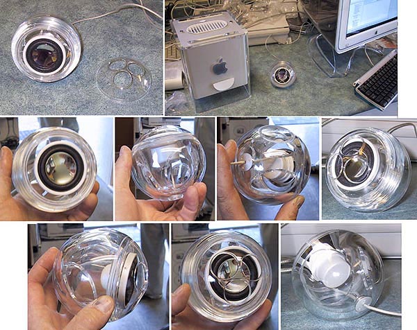

I have a bunch of 2" speakers (12) from a Mac speaker system doing nothing and no worth using for anything really since I don't own a Mac and just thought today that maybe I could use them for a line array Center channel for my HT for right now. No matter what I am going to try them but was wondering what everyone might think of this.
The way they are used right now is in a very small enclosure.... maybe .1 cubes per speaker, I haven't measured yet. I'm sure there is close to nil chance of getting T/S on these little guys. could these be ported? Is it worth it? Is the line array worth it with 12 of them? Let me know your thoughts.

If these are the H-K speakers in the plastic balls, they are rated 8 Ohms. They aren't bad. 1" vented voice coil driving a 1.5" inverted aluminum dome with rubber surround.
If you're using all 12 in a center channel, wire up 3 groups of 4 in parallel (2 Ohms), and wire the 3 groups in series for 6 Ohms.
Thanks Henry! they are the speakers in the plastic balls and they do sound quite nice for their size.

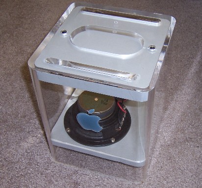

See the sub that goes with the cube:
http://www.cubeowner.com/forums/index.php?showtopic=13516
A very good use for the spare cube shell i have (our working cube served duty as internet appliance at last WE's diyFEST.
