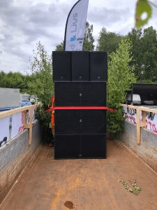

i will put them on a truck bed like this:
there will be people watching from the streets, but it will be people on the truck bed too
you want a single stack with arrayed tops like in the photo, or L+R stacks with one horn per side? will you be building the cabinets?
yes i will be building the cabinets.
it will be a single stack. i was thinking i would do two 2*12" tops, but i could as well just build a single 4*12" box and then a box only for the tweeters. that way it would be less cables to connect, because i will run horns on a separate channel and use DSP, instead of building an XO

You'll want to pay attention to the directivity of the woofers as they cross over to the horn. Ideally the patterns match at the XO. Usually a 15" is used with a 1.4" CD + 60deg horn with a 1kHz cross. The larger woofer becomes more directive as the frequency increases towards the crossover. A 12" will be somewhat wider dispersion than the horn. A quad array of 12" might be OK here too but would err on the other side of being too narrowly directive, with comb filtering as well. Whatever you do keep the distance between the mids and horn as small as possible. Up to you if you want to pursue this design rabbit hole, many dance stack designers don't seem to be too concerned ;-) You could investigate placing the woofers in a V-shaped baffle to better control their dispersion.
You don't want the horizontal horn patterns to overlap and cause interference, so build "trap" cabinets with a 60 degree splay. A listener will mostly only hear one HF source at a time and you will cover a 120 degree wide area. Also think about the vertical aim of the horns, many stacks put the HF up high and pointed straight ahead, wasting most of the horn's output as it flies over everyones' heads. Try to angle the horn down at the audience if possible (yes this makes construction even more difficult.)
