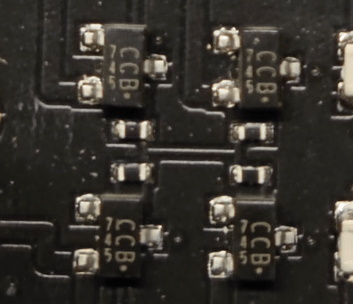

Not sure if its the correct forum, however, does anyone recognize these components? "CCB" 745. This at the output of an DAC, so i am guessing this is may be some protection diodes(maybe 15v zeners?) but they where arranged a bit different than expected. SOT-23 package
It should be a 2SC3326-B SOT-23 transistor
- Type: NPN
- Collector-Emitter Voltage, max: 20 V
- Collector-Base Voltage, max: 50 V
- Emitter-Base Voltage, max: 25 V
- Collector Current − Continuous, max: 0.3 A
- Collector Dissipation: 0.15 W
- DC Current Gain (hfe): 350 to 1200
- Transition Frequency, min: 30 MHz
- Operating and Storage Junction Temperature Range: -55 to +125 °C
- Package: SOT-23
