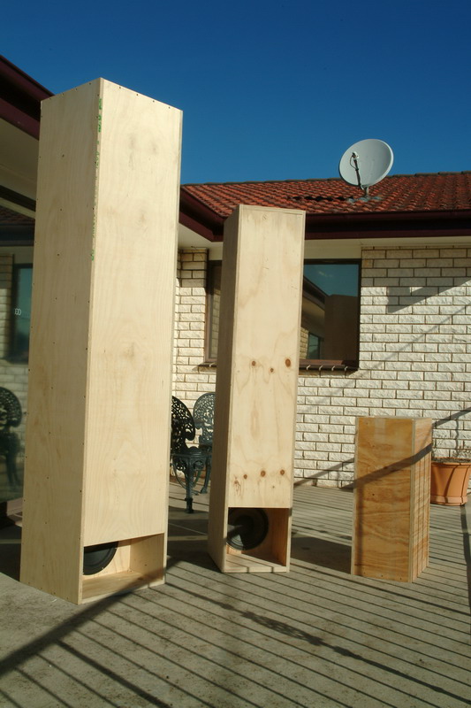

when you talk about size is your concern the footprint??? If so, check out what the aussie does.
Tapped Horn Experiments
Here is a pic of his whole dam family - the 18Hz, 30Hz and 60Hz Tapped Horns
