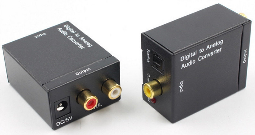

This auction for the top model shows the specifications as

Chipset: cirrus logic 8416

OK so the Smaller model is Cirrus Logic 8416,

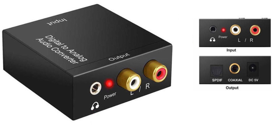

For the second people seem to be using the specs from PROZOR DAC01 Stereo Audio R/L Converter Adapter | prozoreu. Maybe drop them an email ?
The price difference could be the extra circuitry for the amplifier circuit for the headphones and jack, as well as the larger case.
Interesting.The price difference could be the extra circuitry for the amplifier circuit for the headphones and jack, as well as the larger case.
They did not specify that the 3.5mm socket with the headphones symbol beneath it, is a headphones amplifier out.
My guess is that it's simply a Line Out, similar to the 2RCA aside it..
But it might indeed be with a headphones amplifier..

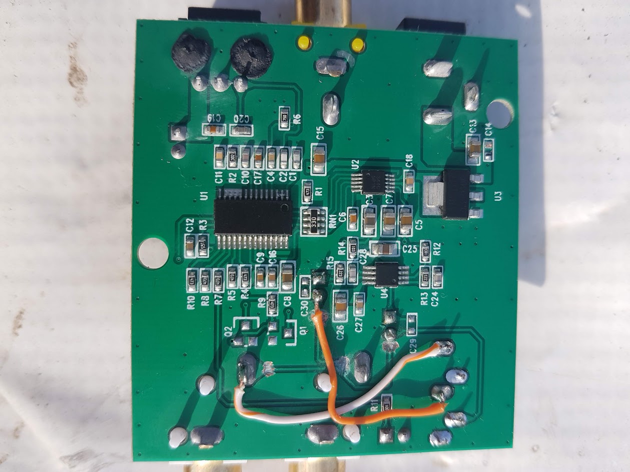

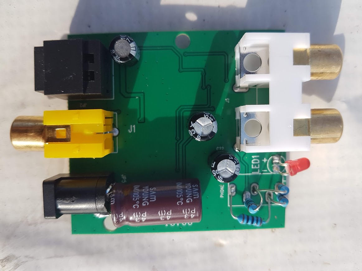

second one uses DAC CS4344, SPDIF converter which i forget, but something standard and very easy to find in google, usually used together with this DAC, and unknown op-amp. there is a schematic easy to find using google. on op-amp output there are only some not so good series capacitors with probably wrong values. very easy to replace them, add 2 resistors to create high pass filter and another 2 stopper resistors. in original didn't sound good when connected directly to amplifier (completely wrong output). with simple rework sounded much better. well, not audiophile, but really very good for its price.
in original RCA and phone out are just in parallel, as probably can be seen on pictures. if my memory serves me well, 'suitable' for headphones in 600 ohm range because of output caps.
