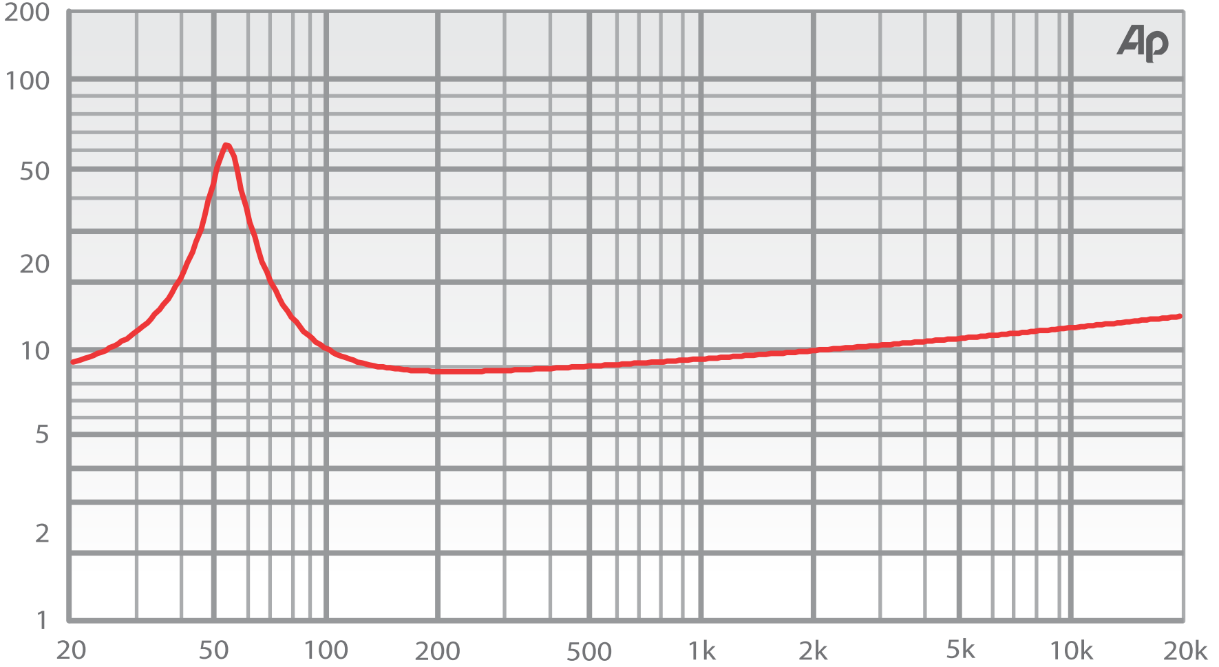

Reason I am asking is that I am considering to use this, or a similar amp on an 8 ohm speaker (with an impedance peak of 50 ohm at the resonance frequency at 50 Hz).
The 8 ohm impedance limits the max output considerably, I assume 3 / 8 * 350 = 130 W? because of the voltage limitation.
Now, if reaching the voltage headroom causes the increase in distortion, then an 8 ohm load will not allow me to use the remaining power in the amp, but if reaching the max current causes the distortion, then I could push the amp to its limits, because the current will be much lower than with a 3 ohm load.

For my further education: given that the output is governed by the voltage and hence the impedance of the speaker, I assume that the maximum power output to the speaker at the resonance frequency, where the impedance rises (see chart below), is even significantly lower.
So that would mean a serious drop in bass output in this area. Is this the same phenomenon as the common bass drop off below the resonance frequency? Or will it be an additional effect as one is a voltage limitation and the other a physical speaker (in cabinet) limitation?
Adding a bass boost equalization won't fix this peak if voltage is the limiting factor, but perhaps it might help (a bit) at frequencies below the resonance peak?
Or is the resonance frequency where the THD starts to rise first because of voltage limitation? That would mean that, to stay within 1% THD also at low frequencies, the available power output is even less...

The resonance frequency is located at the pole frequency of the speaker's transfer function (assuming closed-box, i.e. 2nd order). The Qtc value is the determinating factor of the SPL drop at that frequency. With a Qtc of 0.5 you will actually have a 6dB drop at that frequency and with a Qtc of 1 you will have no drop at all.
Efficiency-wise the resonance frequency is not your enemy at all: There is usually less drop in radiated power than there is in consumed power. I.e. you do even have a little increase in efficiency at that frequency.
The reason why many class-d amps have 10% THD at nominal output is exactly because those manufactueres simply define their output power with 10% THD. They could as well state the output power at 1% THD - which would be more honest actually. But then the max output power would look less beefy.
But there is indeed some rise in THD for some class-d topologies long before the amp starts clipping. The reaon for this is found in the so-called ripple aliasing error: There is a signal-dependant shifting in time of the modulator sampling point taking place.
