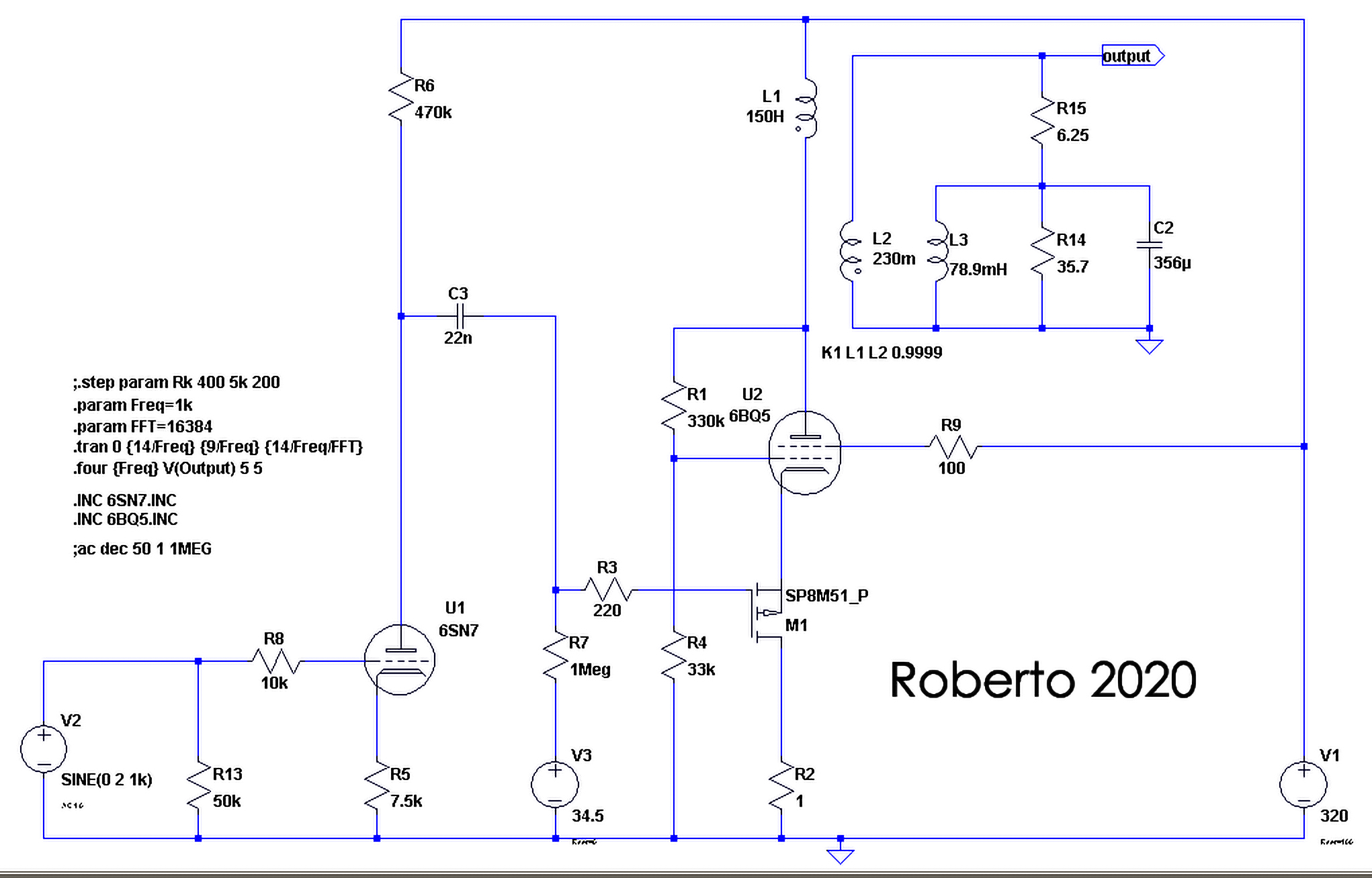

I will post a simulation of the 1x 6SN7 + 2x 6BQ5 stereo amp in the following evenings.

So this can be the SE amp with 6SN7 and EL84.
PS the pmosfet on the cathode is not the right model.
This is the simulation with 2Vp at its input, on 8 Ohm:

Most probably not, me thinks, 'cause this tube is from 1940 and doesn't see much use nowadays anymore.

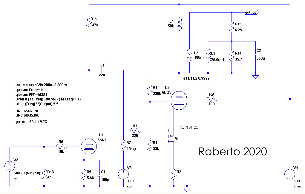

Here it is an update on the SE amp now with different polarization for the 6SN7 and EL84 with 6k6 Ra load. Output is 8 Ohm:

Appears to be very clever with that local NFB by a voltage divider that also sets - and simultaneously stabilzes - the EL84's operating point
