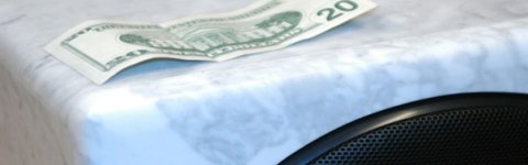

let's make speaker cabinet, using real marble coffers
it's realy not expensive, but you'll completely satisfied of quality and by sight 🙂

Yury,
Good idea for compact sized speakers ....but. Have you seen the large speakers in my avatar? They weigh 300 lbs each! That is with 125 lb. of sand in filled L & R side surfaces. In marble these behemoths would easily weigh 1200+ lbs each. 😱
I don't know anybody that has forklift and loading dock to their living room. I used to but that is another story. 😀
you're right, but I made big cabinet ones. I'd assembling it on the place, in the room of customer. it's one way.
second one is - makes it by thin panel. paste it on the wood cabinet. 6mm-10mm. you'll get nice design, best acoustic parametres and not very heavy.
ok. I see. it's not easy, but the same as sandwhich....
good luck.
