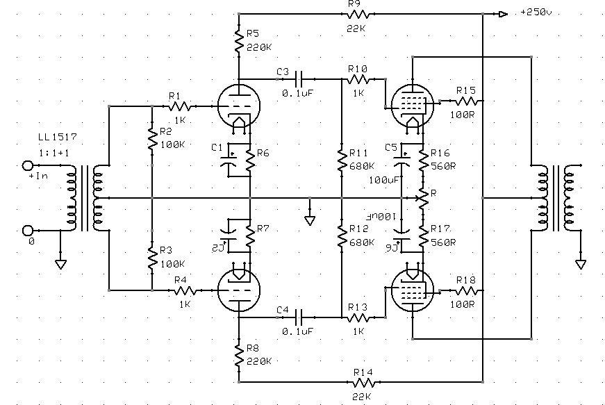

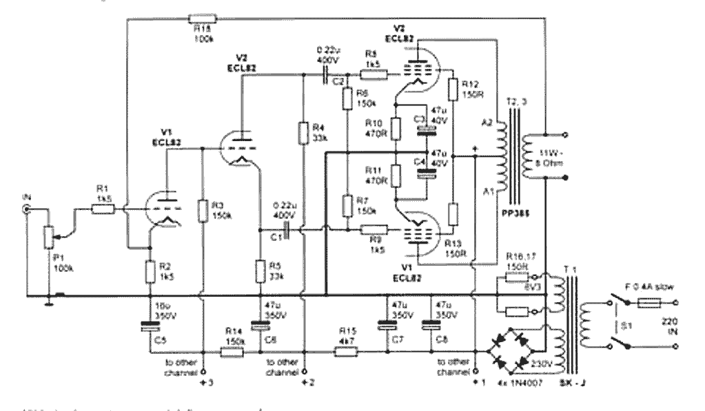

Attached are 2 schema pulled from my collection that show the 2 topologies these tubes are usually used in. I'm partial to the LTP phase splitter. A CCS or a big B- makes the input trafo moot.

Cool! It looks less intimidating. I did also find a simple amp using a 2a3 tube that is a SE amp. However... being this is using the tubes I want to use. and I can usually get them inexpensively. I can build it in stages.
