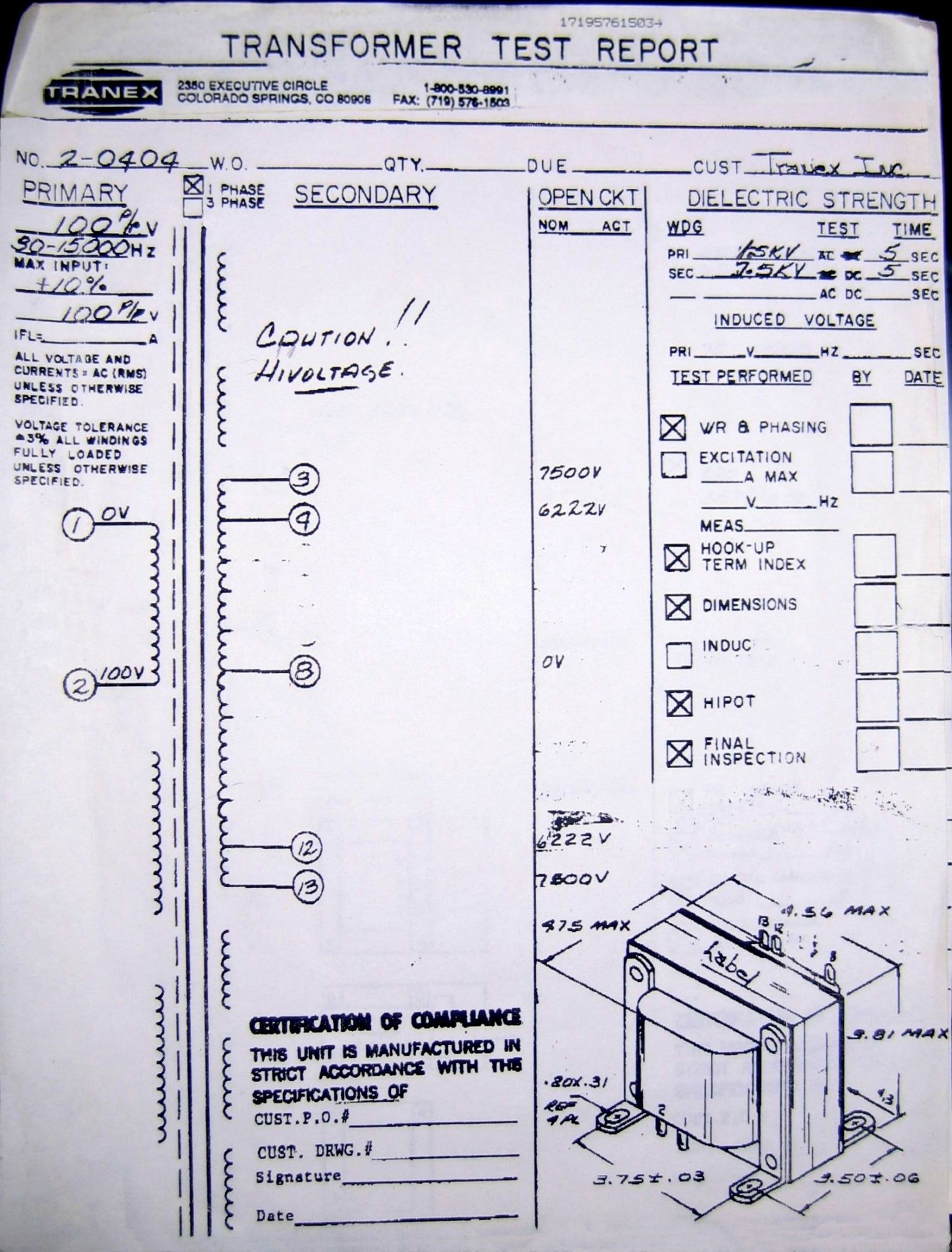

I thought this sheet had more specifications on it, but here it is anyway. I had a note that the leakage inductance is 5.9 microhenries. I didn't measure it myself though, so I don't know if that's accurate.
These were made years ago, and Tranex was bought by a larger transformer company, so as far as I know they are no longer available. It's just an example of what a single high-ratio, wide bandwidth transformer is like.
If by saying you will "try the full range" you mean you don't intend to segment the panel, you may have trouble getting sufficient high frequencies with a single high-ratio transformer. That can be calculated if you know the leakage inductance. Also, with a wire panel, it's a lot easier if you wind everything with the intention to segment. If you decide you want to try unsegmented, putting all those wires on one terminal is a lot easier than trying to go the opposite way and having to cut wires after the fact and splice into them. I have done that, and it was a multi-hour job.

hello mattstat,
Thank you for showing us your valuable materials.
Using a wire panel, first make a full range.
Depending on the result, I will devise and make it so that it can be segmented.
Now, let's consider what kind of specifications we will use to order the optimal step-up transformer for a full range.
Buying a commercially available product may be more efficient and cheaper, but there are few options.

The RC transmission line segmented ESLs present a much friendlier load to transformers - a mix of resistive and capacitive load with the effective capacitance about 20X smaller for the same sized panel. Small toroids work quite well, 15 VA toroids with the 230V windings in series and low V windings in series and/or parallel to get the input rating you require (~ 25V at 50 Hz) work well. Commercial transformers are normally made to withstand 4kV between primary and secondary, so should withstand use in ESLs. Be sure to avoid transformers with the dual 115V/230V windings - these have a very high capacitance and are no good. With small toroids, you can get step up ratios of 120 easily, and with large purpose-built EI transformers, step up ratios approaching 200 are possible. A pair of the ER Audio (each 1:90, the pair giving 1:180) transformers in a push-pull arrangement work well. With segmented ESLs you get a flat frequency response over about 10-15 degrees of angle - actually a better polar response than many conventional speakers.
In general, the larger the ESL panel and the lower the frequency response you require, the bigger the transformer required and the lower the step up ratio that can be achieved. Also, whatever the ESL design, you need to keep them away from rear walls (> 1m) to avoid low frequency cancellation from the sound reflected from the wall.
こんにちは、maudio、mattstat、golfnut、
トランスフォーマーの具体的な目標を教えていただきありがとうございます。
実現できるかどうかはわかりませんが、トランスのメーカーさんにできるだけ大きなコアと巻線比を相談してみます。50Hzで8kVpp出力。高価で注文が難しい場合があります。
私のアイデアは、AudioStatic-DCI のようなスピーカー システムを最初に作成し、結果に応じて改善することでした。
あなたが言ったことから、セグメンテーションは必須のように思えます。
参考までに良い例を教えてください。
念のため、セグメンテーションについて教えてください。
1: esl_seg_ui.exe を使用して生成された抵抗を使用して ESL ビームを回避する方法ではないでしょうか?
2:ESLパネルとトランスをバンドごとに使い、ディバイディングネットワークで分離したスピーカーシステムのことですか?ESL-63のように。
参考までに良い例を教えてください。
