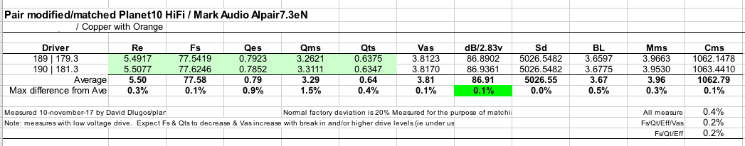

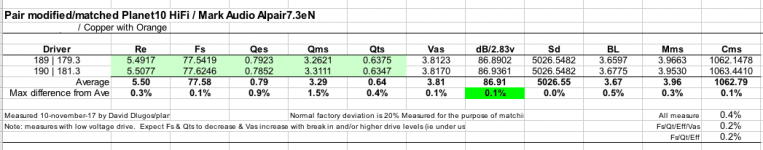

One can match T.\?s parameters… as i do with my matched pairs (a good example attached, the set of metrics in the lower right need to be <3%, the sensitivity within a quarter dB), or go even further as Chris suggests, measure the FR and match that. Often done at the component level.
To match both you have to have a lot of drivers to match.
dave
