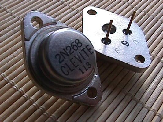

Germanium Power Transistors
if you are looking for
germanium power transistors ( >= 1 Ampere )
it is not many complementary pairs PNP + NPN
There are however some powerful devices.
I have found one guy selling NEW EXEMPLARS in Original Package of these:
> 2N268 .. PNP .. 80Volt 3Ampere 30Watt .. looks almost like TO-3
> OC16 .. probably PNP ...in older power case
They do NOT come cheap 😎
Complementary Pairs. Often used are:
AC127 + AC128 0.3 / 1 Watt
AC187 + AC188 1 / 1 Watt
So 🙂
AC187 (npn) + AC188 (pnp) are one of the few Pairs above 1 Watt
See attached picture of 2N268, 30 Watt PNP
