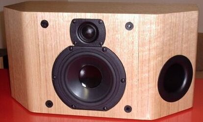

Nice combo for a TM centre is Vifa D26NC tweeter and Peerless 5" HDS 850528 woofer. Makes for a nice low profile for a centre.
This is one variation I've done (Vb=11.3 litres).

Yeah Michael
It's a series xo, 0.5mH inductor + 3.4uF cap + 10ohms resistor (in series with the tweeter) with the same layout as the other one I sent you.
On another centre Vb=8.3 litres with the same drivers has 0.47mH + 3.3uF + 9ohms.

The D26NC works surprisingly well. When testing the crossover it was done with music and blended with the HDS driver nicely, maybe it's the series XO - don't know for sure.
I like this TM configuration on centres due to problems with MTM on phase cancellation which is a function of driver centre to centre distance, off axis response, combing etc. Most of the audible problems are for those sitting off axis and I don't think it's a major problem for those on axis. I just don't like the idea of having a speaker that normally has 10° vertical, 40° horizontal dispersion having 40° vertical, 10° horizontal dispersion when in a MTM configuration.
The angles on the side are only there to reduce the baffle width and allow large radii.
Michael
The XO is at 3525Hz and 6dB slope. Due to the series XO tried to have XO about 3 times the tweeter Fs.

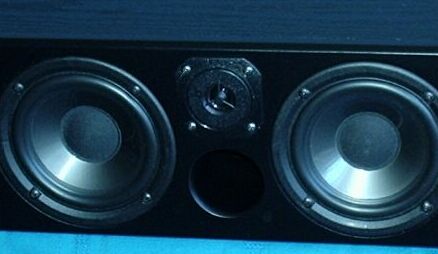

If you want the port near the tweeter, move the tweeter towards the top of the box and place the port underneath such as this pic. Install the woofers each side at an angle of 20-30°.
how would i modify that XO for use with 2 parralel woofers, making it 4ohm?
and also what do you mean drivers at an angle of 20-30degrees? do you mean 20-30 in relation to that tweeter so forming an upside down V?
ok now i just though any know the affects of facing the woofers slightly away from forwards so 5-10 degrees to either side... would this improve off axis response of voices for those sitting out othe swet spot...or would it simply destroy the sound stage and create voices at the let and right walls? i think i just got a headache:xeye:
Michael
For 2 woofers in parallel change inductor from 0.5mH to 0.25mH.

Have a look at the Dynaudio 42C and read the reviews. You can get a low profile and still use TM instead of TMM. With a HDS woofer you would get a very low profile and you could use any shielded tweeter of your choice as you wouldn't need the low profile of the D26NC.

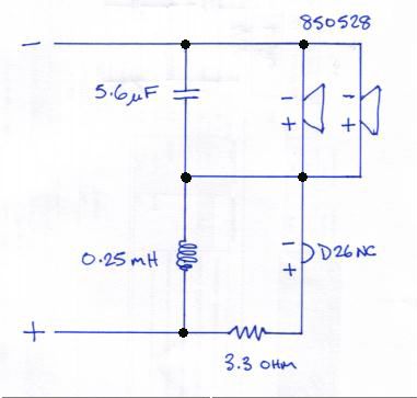

OK Michael
The 2 woofers changes the xo as follows:
R=3.3 ohm, Inductor 0.25mH (can use a 0.22mH), Capacitor 5.6uF
Also buy a 2.2 ohm, 2.7 ohm and 3.9 ohm resistor and try each of these instead of the 3.3 ohm to see if you like the sound better - don't solder them in until you find the sound you like. Not expensive as 5W wirewound resistors are only about 30 cents each.
You need a meter that measures inductance if you are going to unwind a 0.33mH to 0.25mH. I've done it before by weight, measuring resistance and even uncoiling and measuring the length of wire. Real pain but can be done. You'd have to lose 25% of the wire to come down to 0.25mH.
i never have any luck putting pictures up here so ill try something silly instead... is this how the XO should look.
+ -----------0-----------------------------|
C 3.4uF W
| T
L 0.25mH |
- ---------0-------------R---------------|
3.3 ohm
is this right, if so great, oh and what sort of meter do you use to measure inductance mH cos my multi meter does not have an mH on it, is it something different, if i cant do it this wat i suppose i could use the weighing method... do you need to take the weight of plastic reel into account?

2.7mH???????
I hope that's a typo on your inductor as it should be 0.25mH and not 2.7mH.
If you use a 0.33mH you need to lose 2 rows of wire to bring it down to 0.25mH. As far as weighing goes, allow 4 grams for the plastic reel on the Jaycar ones. If you want to measure the inductance you need something like the Jaycar QM-1445.
Some 5W resistors too?
Here's the XO diagram - wires are joined at all intersection points.
