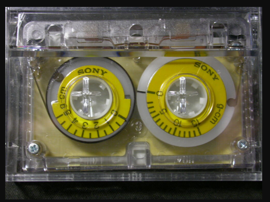

One check you should do is to confirm the back tension is correct... however that needs a special test tape to perform that test. This one also measures the take up torque.

I can't even imagine how expensive this is, if this can be found at all. So I am afraid this is not an option...
