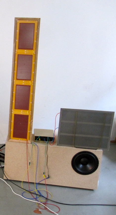

Hi Olaf
my system is:
2 toroidal transformers 1:65 ,
regulated bias supply
the tall speaker has 4 panel each 6 inch x 10 inch ( 15 x 25 cm)
the grey panel is 16 x 20 inch ( 40 x 50 cm)
a tl with a peerless sls10
coated with elvamide.
behringer crossover
behringer amp reference500
I'm experimenting how o to put all things together it sounds ok but not so good it's hard to match the tl with the esl and daming the tl more or less makes not much difference to me
my priority is now to get another amp.

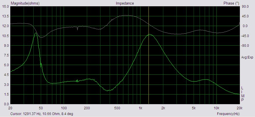

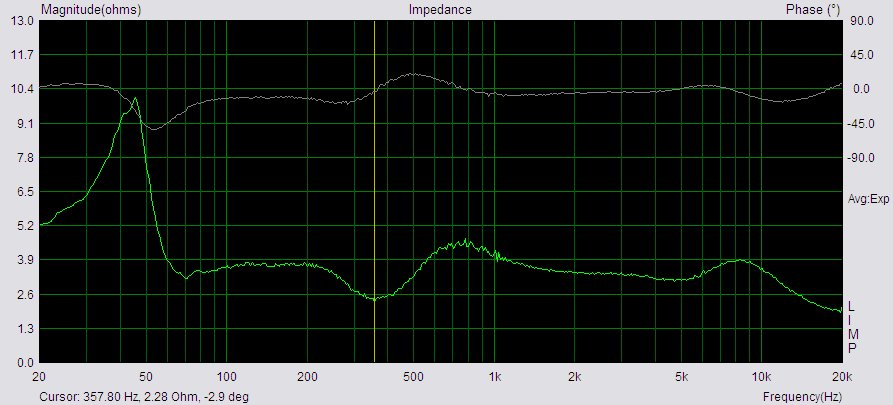

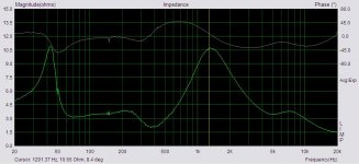

Hi hironimo,
I'll give you an example, concerning impedance correction.
If I measure the impedance over frequency at my ML Sequel2, I get the diagram as you see in the first left pic.
After adding an impedance correction, I get the curve as shown in the second pic.
Tube amps in general have lower dampening factor in comparison to solid state amps,
as a result, the peaks in impedance response produce a peak in frequency response
(in my case up to 4 dB more in the midrange with the Sequels if impedance is uncorrected).
The corrected impedance gives a nicer load for the amp,
also the phase twist is lower. All in all the sound is better.
Even SS amps can benefit from this correction
(although, with my Vincent it's not necessary/ audible).
You need only three parts (if you don't flaten the imp peak in the bass region).
This parts don't have to be high quality parts.
You need a coil, a resistor (cheap cement type, 5-10 watt) and a cap
(electrolytic is sufficient).
The values I needed were: a coil with 0,15mH (0,3ohm),
a 4ohm resistor and 47 mF cap (not milli, but micro, I can't put the right sympol in this editor 🙂
This three parts have to be connected in serie from the minus to plus terminal of the amp (or at the speaker terminals).
Of course, the values are for the sequel, but may work with your combination, too
(if you should decide for a tube amp).
