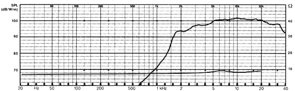

The Visaton TL16H horn tweeter has fs around 6 kHz and the recommended crossover is 7 kHz. But, as shown below, the response looks useable (to my uneducated eye) all the way down to 3 kHz, and the impedance peak is hardly noticeable at fs (again, to my uneducated eye).
What do you think would happen if I used the TL16H with a 3 kHz, 24 dB/octave crossover?

usually the rule is 1.5 - 2 octaves above for a shallow crossover on a driver..it "appears" that from 5k down to 1.8k the natural roll off is about 6 dB per octave, below that it looks like 15 dB or so. If the resonant frequency is say 7k, I'd go at least one full octave above or 14k! , 1.5 would be better @ 18.2K
This Visaton is listed as a super tweeter , and that is what it would indicate. Visaton even recommends a Xover frequency of 7.5k on their site.
There are phase differences caused by the tweeters rolloff that you need to incorporate into a design. (Crossing close above fs and) reducing your crossovers slope at fs can fix this but power handling will suffer.
You want the slope to be smooth below the crossover frequency for an octave or two as well as above. Once you get down to below 2kHz, this becomes impractical.
