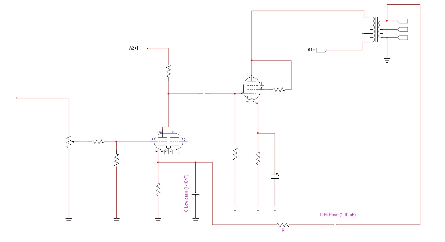

Hello, I've tested with very good sonic results, that I can flat the frequency amplifier response to less than -0.5 db in 20-20khz range if I put a pass band GNF. Overall the bass is very good just to include the C in the range of few microfarad.
What you think about this selective band feedback ?: I think it both enhances presence and low bass and increase the amplifier stability, so all pros and I don't see any cons, overall because ears don't recognise distortion below the 100-50 Hz.
I don't see this C Hi pass capacitor in any schematics...😕
The two capacitors values must be found with a spectrum analyzer, of course till to reach flat response, because it needs to correct the transformer curve first, which is out of any calculation or simulation.

The difficult stuff is to select the two C values, for which you need a good model simulator or a decent analyser, to make the curve flat.
Actually, if you route global NFB around the OPT, the OPT itself already forms a band pass filter in the NFB loop. Why anyone would add another band pass filter in the NFB loop totally escapes me.What about a pass band feedback in SET amplifier?

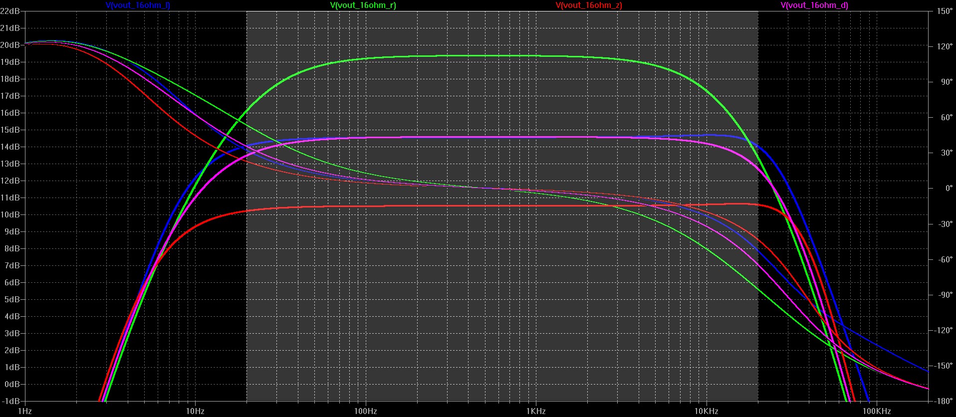

Maybe the graph better explains.
Concentrate on the gray area (20-20KHz)
1) green: no GNF
2) pink: -5dB GNF no Cap
3) blue: -5dB GNF plus Cap_Hi (2.4uF) plus Cap_Low (6.8nF)
4) red: -9dB GNF no Cap
So (3,blue) and (4,red) have the best extension in the 20-20KHz, but (3, blue) has more gain, more stability at HF and less GNF than (4,red) [for the folks who hate GNF sound].
I see you simulated your amp in spice, and understand the idea and curves pretty well.
Can you post the same four graphs, but taken at the output tube's grid, and not the 16R tap of the OPT?

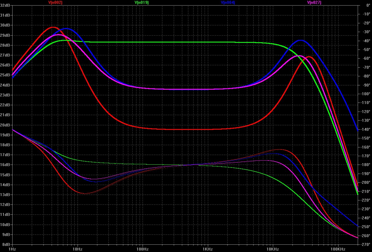

Hello, here's to you, at the input grid of the KT77, if I'm correct. I'm curious now to know the purpose. Thanks! GG

Thanks for the diagrams. It just shows, to flatten the amp's output at the extremes of the bandwitdh, you need to up the signal at the extremes at both low/hi freq's. Yes, your band pass network works as intended, but you would just achieve the same by increasing the nfb by about 1~2 dB (which is a better alternative overall).Hello, here's to you, at the input grid of the KT77, if I'm correct. I'm curious now to know the purpose. Thanks! GG
You need more. 😎 You would need nearly to double the GNF (from -5 dB to -9dB) to get the same effect: but high values of GNF in a low power Single Ended are dangerous for HF stability and, my impression, will kill the amplifier sound (with constricted dynamics and sonic harshness). 😱
