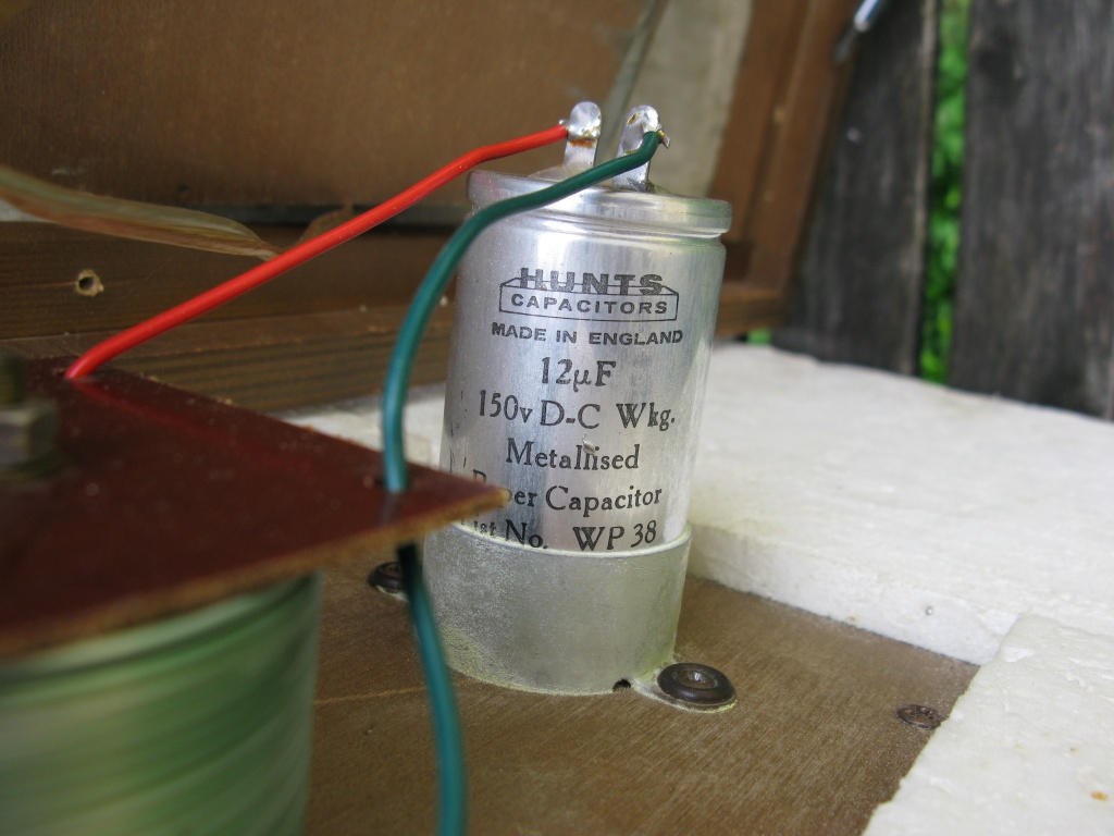

The link below shows a metallised paper capacitor in a W2 crossover (see also the attached image).
Wharfedale W2 - Le forum Audiovintage
Later models than yours will have used this less expensive substitute for the oil capacitors.

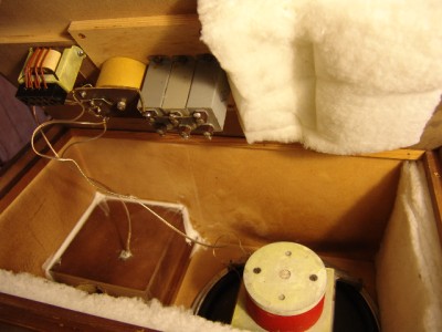

It looks like the early W2 pictured below is fitted with a tapped choke level control.
