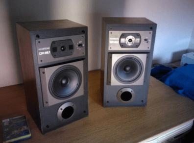

Hi Neddy! I'm including details about your speakers in order to to give your request a bump.
TSR108: Its bass/midrange driver is just under 8 inches and has a cone made of a new mineral-filled homopolymer to reduce cone breakup and resonance problems. The tweeter is a 1-inch soft-dome unit. Frequency range is 35 to 25,000Hz and amplifiers of 15 to 80 watts per channel are recommended.
The image below shows the TSR 108-2.
The TSR 108 was the smallest speaker in Wharfedale's TSR (Total Sound Recall) range, which extended to the TSR 110 and the TSR 112.

I can't find an image of the 108 to compare with the 108-2 shown above, but I assume the drivers are the same.
Sometimes only cosmetic changes are made to the external appearance to produce a mk 2, but often the crossover components are upgraded.

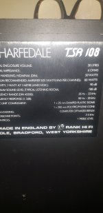

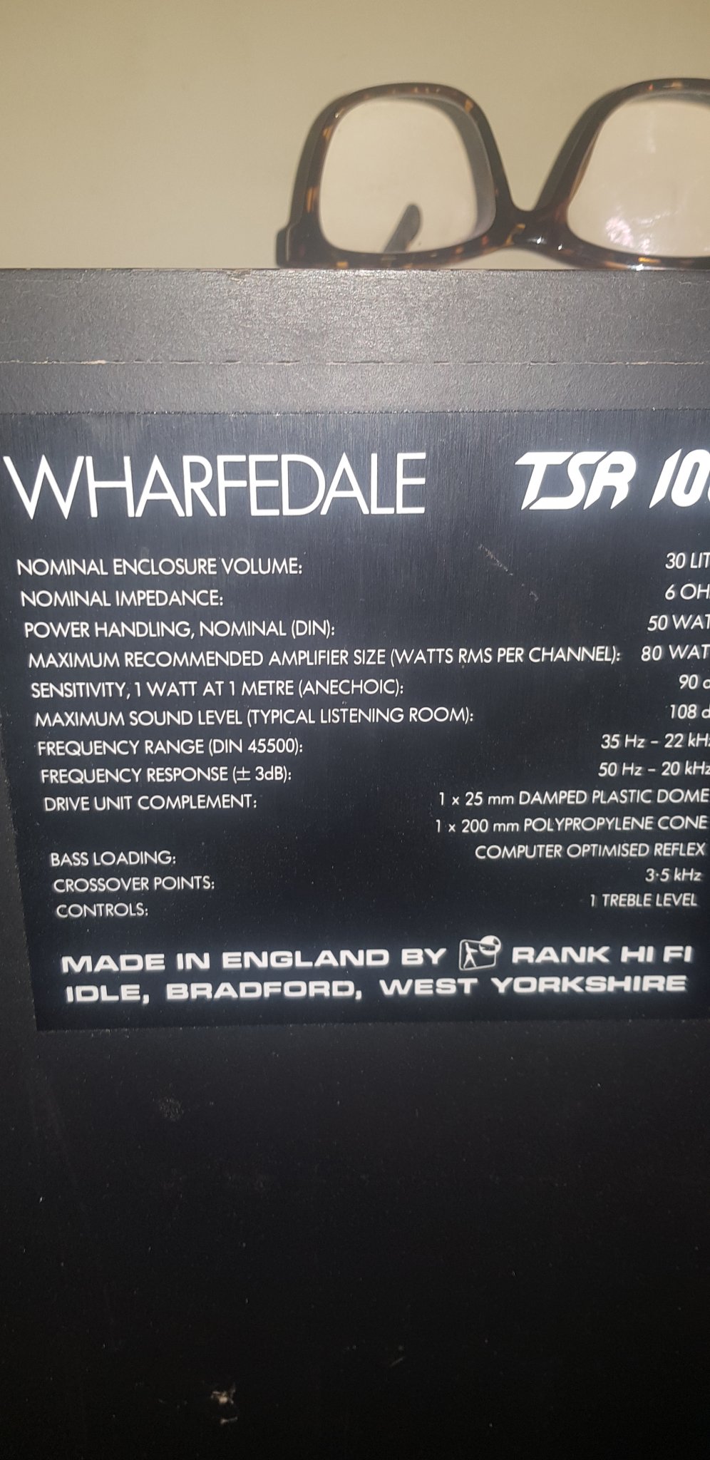

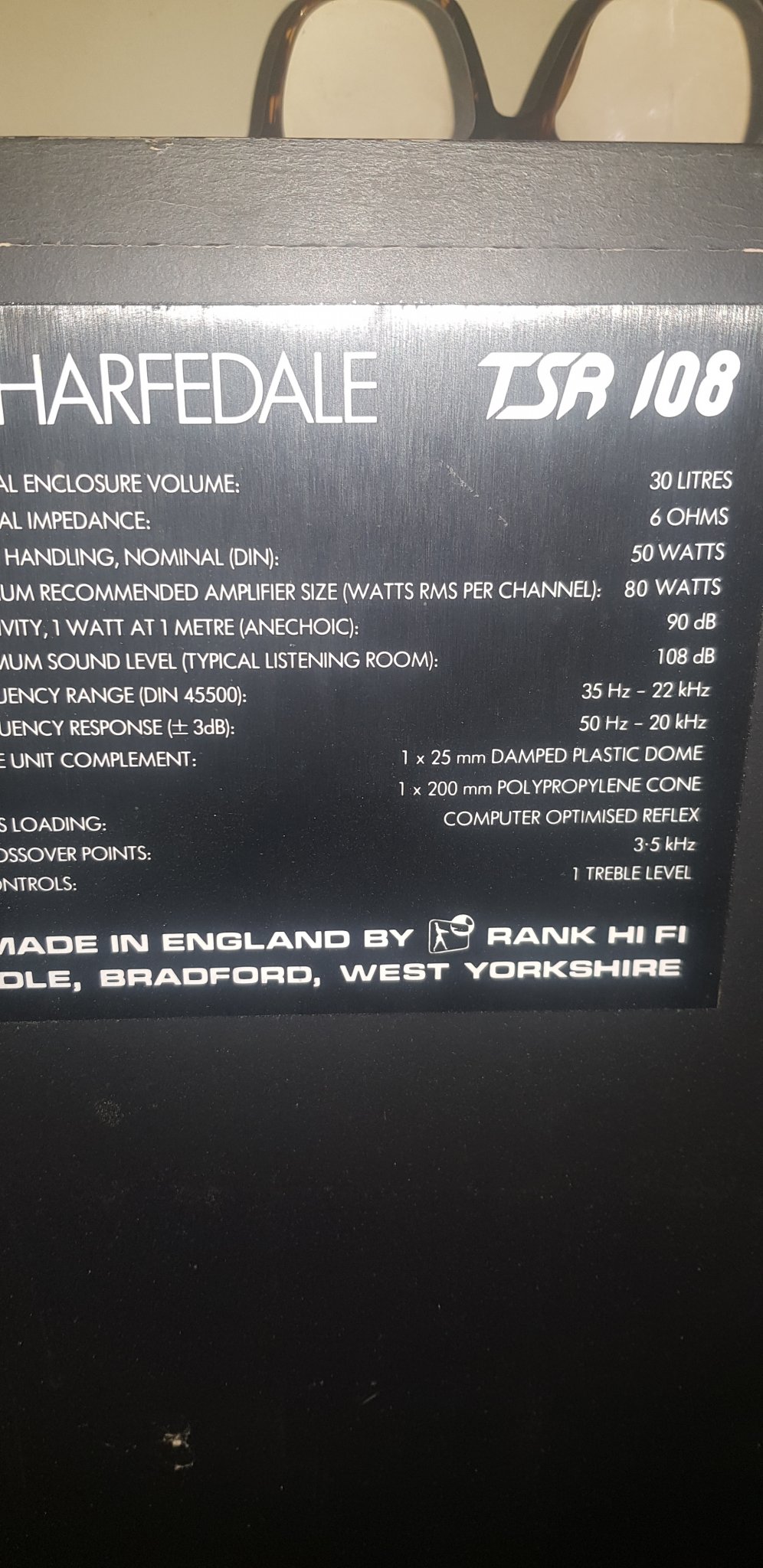

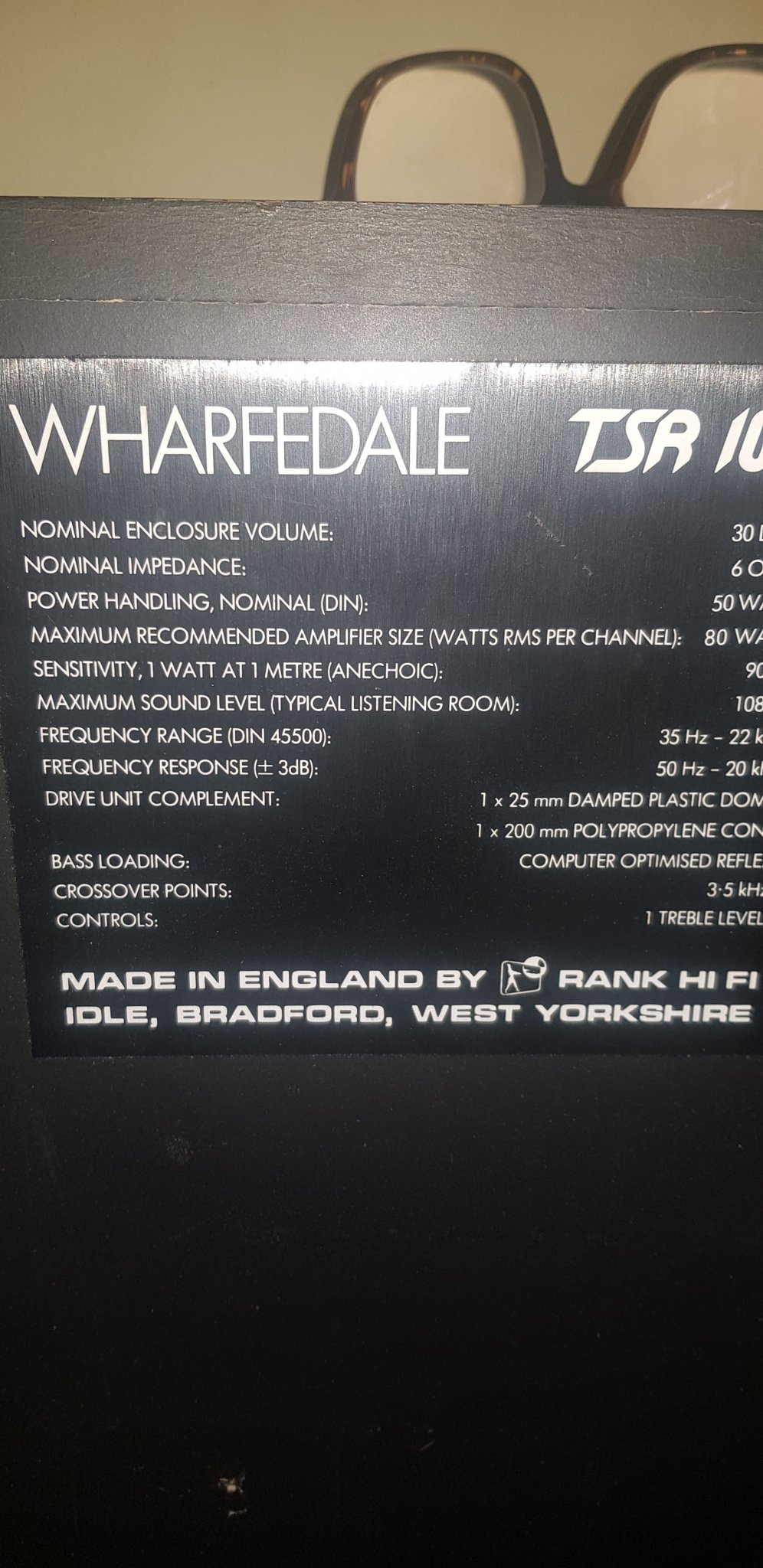

I also see in the thread from which you got the port lining suggestion that the plaque on the rear of the TSR 108-2 gives the following information:
88 db/watt, 30 litre box volume, -3 db @ 45-25 kHz, 8 ohms impedance, 100 watts, 2 x 12 db 7 element crossover at 3.5 kHz.
Is there an information plaque on the rear of your TSR 108 originals?
The same source states that the TSR mk2 versions contained electrolytic capacitors.

I thought that change had been confirmed through comparing the specs from the two information plaques.
Measuring the DC resistance of your woofer with an ohmmeter will help confirm its nominal impedance. Just add one third to the ohmmeter reading.
