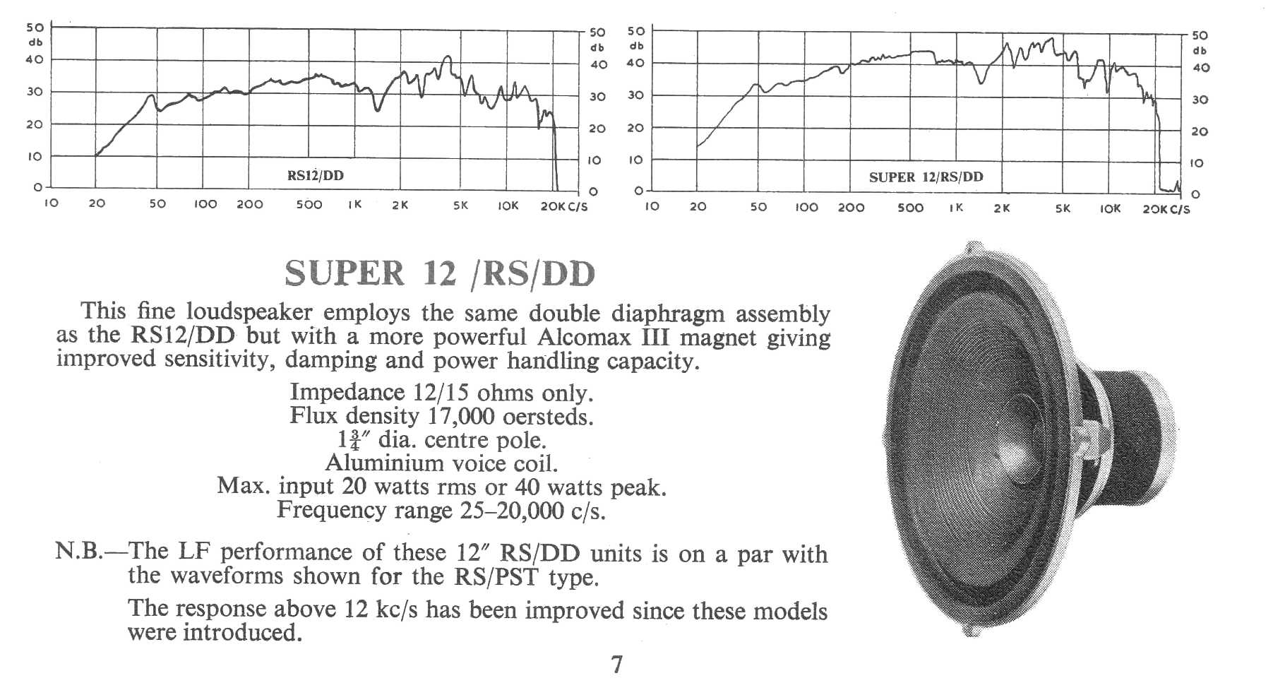

(some) specs:
Here is a clip from the Wharfedale General Catalogue 1962, showing their specs. for the Super 12/RS/DD. Do yours match the description? From what I know, the "RS" refers to "Roll Surround", which was a half-roll formed of fine cloth. Cloth surrounds generally tended to be a lot more durable than the ubiquitous foam type. You mentioned you are considering "refoaming" yours, and it makes me wonder why.
Another question for you: do you know of a place that will re-cone these or supply parts for that job, and if so, how close to original would the parts be? I myself have a Super 8/RS/DD with a broken (aluminum) voice coil, that I've been unable to repair, and would dearly like to restore the speaker to it's original performance, but so far have not found a source for suitable repair parts. Personally, I think the Super 8 in the right system would have great potential - the Super 12 even more so.

Mine look just like that except that one looks like it has a small whizzer - mine doesn't have one. I don't know what type surround it had as the surround is now completely gone.
I was going to check with Orange County Speaker or Simply Speakers about repair, but I don't know that they have the right parts.
