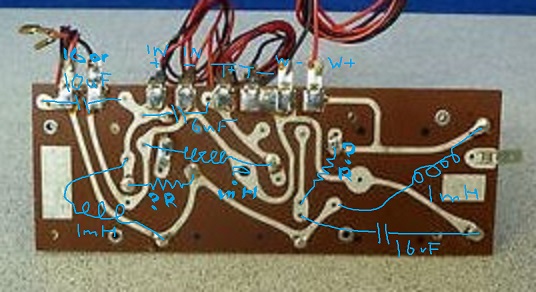

Enter the Wharfedale Shelton XP2. I had a vague idea that this was a 20L closed box 8" bass plus 3/4" mylar tweeter design. A design about the size of a very big box of Kellogg's Corn Flakes. Which probably meets the WAF criterion.
TBH, they aren't bad for £30. It all works. Good bass response. The expected lively mylar tweeter response in the KEF T27 mold. I am very pleased with them. I was expecting a big roll of stuffing inside the closed box. And it turned up. The crossover completely surprised me. 8 elements!
So far I have counted 2x 1mH coils, two 16uF Elcap NPE caps, and a smaller tweeter coil around 0.3mH and perhaps about 3uF cap. Big surprise is a couple of tiny elements around 33R resistance and 0.47uH. I think this must be a BW3 design with some consideration to RF impedance. Ah well, we shall investigate further this Golden Age of British speaker design.

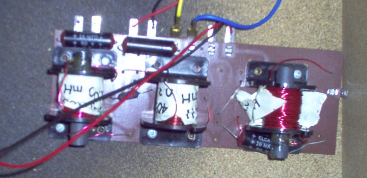

Further investigations of the Wharfedale Shelton XP2 this morning. I am picking out 2x 1mH coils, 2x 16uf NPE caps. Maybe a 0.3mH tweeter coil and 6uF tweeter cap. Plus a couple of minor low-power resistors. Unfortunately, Wharfedale have glued the crossover to the cabinet, so I can't trace the connections without wrecking it. IMO, the two small resistors do almost nothing.
I got my measuring tape out. We seem to have room for a 98mm H1283-06 22TAF/G replacement metal tweeter here with a minor enlargement to the 80mm tweeter cutout. I am inclined to keep the Wharfedale 8" paper bass. For one thing the bass has my preferred almost transparent cloth dust-cap. If you didn't know, the only real reason to fit a dustcap is to stop iron particles falling into the magnetic gap.

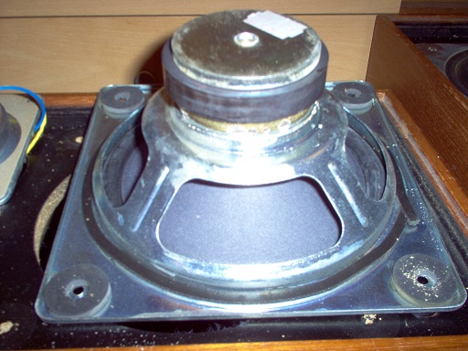

OK. Here's the front view again. Paper cone, rubber roll surround and fairly transparent light undoped cloth dustcap. 5.6 ohms DCR.
645707d1510650443-wharfedale-shelton-xp2-minor-classic-imo-wharfedale-8-inch-woofer-jpg
Woofer 185mm baffle cutout, chassis 205mm square.
Mylar tweeter 80mm baffle cutout, chassis 110x 90mm.
The labels on the back of the drivers are just stock control gibberish AFAIK. The 4 rubber grommets are flush with the frame. And the two shots you want.

Ringy dingy stamped frame. Some of us consider the basket the stealth offender in standard bass-mid drivers like this. I was hoping for a slab of alloy but hey! You filter wizards can correct any flaw, right?
OK it's a cool speaker. I would be delighted with it, as I started out with AR-4x...
Ringy-ding probably describes pressed-Steel chassis. TBH, I don't mind them.
645839d1510696241-wharfedale-shelton-xp2-minor-classic-imo-wharfedale-shelton-xp2-drivers-2-jpg
IMO, the biggest filter mistake you can apply to pressed-Steel chassis is a notch filter. You might get away with a notch with solid-Alloy chassis. Like Celestion or SEAS have a good reputation for.
Why? Because you might be stopping the cone dead, But the pressed-Steel chassis rings! The Energy will always find a way out. 😱
It sounds HORRIBLE. My own personal preference with pressed-Steel chassis is a 4th order filter.
It must make far more sense to just ask a speaker chassis to not to even go near it's weaknesses.

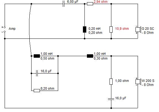

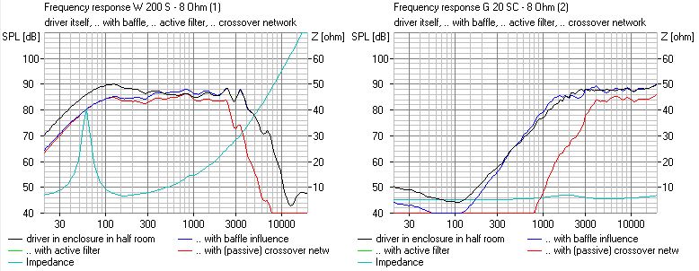

Hi there speaker fans! Here's the promised update on my delvings into the remarkable Wharfedale Shelton XP2's crossover. 🙂
645295d1510487763-wharfedale-shelton-xp2-minor-classic-imo-wharfedale-shelton-xp2-grille-jpg
It wasn't what I expected at all. But it was helpful that Wharfedale used that circuit board in loads of designs. Even three-ways. So I could find the back view and trace it. A flippin' 1.5kHz trap there. Haven't seen one of those since the glory days of KEF 8" bextrene units! 😱
FWIW, here's Troels Gravesen's thoughts on this sort of high-efficiency thing: High Efficiency Speakers
The images speak for themselves. 12dB/octave electrically. Quite remarkable to get such steep 24dB/octave acoustically on the woofer just before the 3KHz breakup area. About 18dB/octave acoustically on the tweeter. Only thing I could criticise is the rather bumpy impedance. But a good sounding speaker.

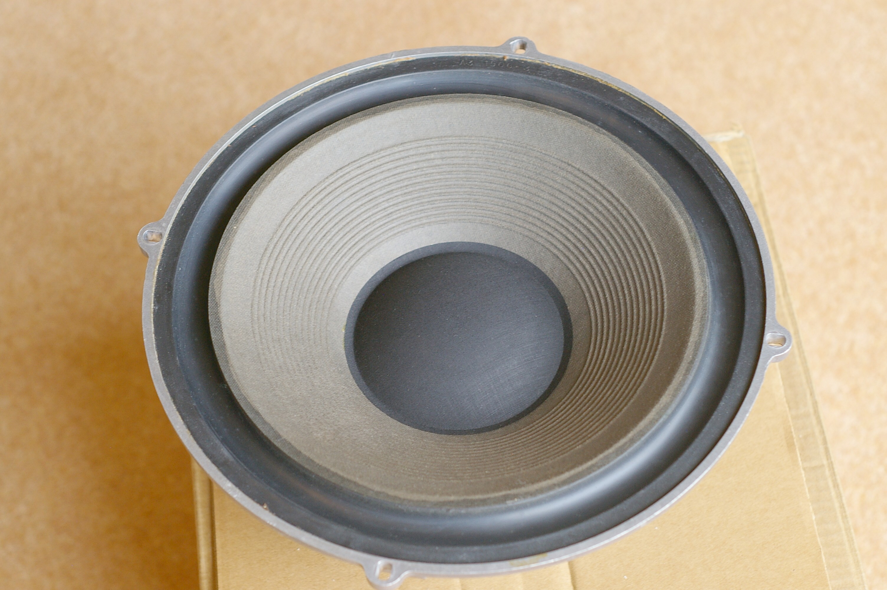

In comparison, here's a Wharfedale Dovedale 3 bass driver with a die-cast aluminium alloy chassis.
The well known benefits compared to pressed steel are greater rigidity, less resonance, accurate dimensions and open construction.

And, for you cone oglers out there, here's a front view of the Dovedale 3 woofer!
As you are no doubt aware, the Dovedale 3 woofers were engineered in the days before T/S parameters.
However, I can give you the following information:
The dc resistance is 6 ohm.
Flux density is 135,000 maxwell.
Free air resonance is 25Hz
Crossover frequency 600 - 1,500Hz.
More usefully perhaps - the response will be 3dB down at 45Hz in a 45 litre sealed cabinet.
Hope this is helpful.

I am really interested in hearing more about the Shelton crossover design. How important is the 1.5kHz notch filter in relation to this particular woofer?
Wonder how the system would sound with a lower order crossover arrangement?
