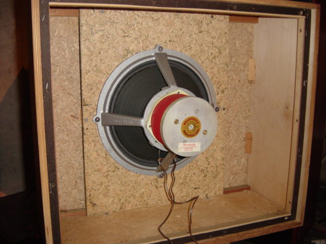

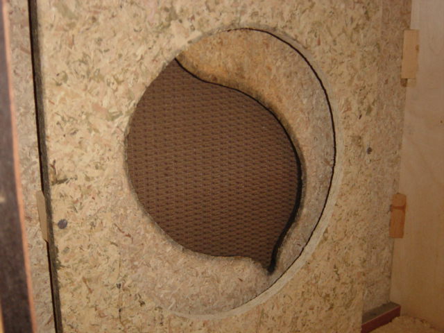

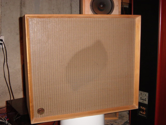

Thanks for the info guys.I'm definitley interested in those plans.They are currently in RJ enclosures and measure 24"wide,21"tall and 10"deep.They are vented in a way I've never seen before.The drivers are mountd on an inner baffle set back from the front with about 1" blocks so it is vented through the speaker opening.The opening is smaller than the drivers and shaped something like a back to back rain drop.I would think the reflections back at the drivers could do some harm but they sound very good anyway.

Your description of the current enclosures sound interesting. Can you post pictures. They sound like a hybrid of the original Helmoltz resonator, and a Carlson.

Sure Geoff,
I'll snap some pictures and get them on.Don't worry about the gifs.I'm in no rush.I'm a weekendend warrior anyway.

Different... It is like the original Helmholtz resonator, except the hole in the front baffle would be the same diameter as that of the speaker baffle.
The front opening may have been to provide wide dispersion of the mids and highs, or it could be artistic license.

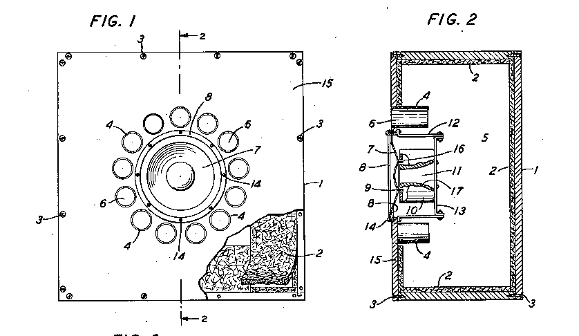

I seem to remember Gilbert Briggs of Wharfedale discussing this type of loading in one of his books. It's similar in a sense to one of the concepts forwarded by Thuras of Bell Labs in their original reflex patent of 1930 (see attached) in that it's attempting to have the back radiation coming from ~the same place.

Yes, Scott, Briggs did describe one, although he did not call it an "RJ" enclosure. He said ..,." spacing the unit a short distance away from the baffle got rid of most of the effects of ( too) small an enclosure, and avoided a sharp rise in resonance frequency."
"In short, the arrangement makes the speaker into a free-edge cone type, except that the very low resonance of the free cone is not obtained.......I now think it is hard to beat for small models and can be looked upon a useful stone which the builders rejected."
He gave a design for an 8"unit, resonance not higher than 65 Hz.
Cabinet 1 cub ft, (24" x 11" x 9" outside), , with speaker on small sub-baffle 3/4" back from front baffle. If no sub-baffle used he suggested space of about 1/4". Front hole circular but could be slot to reduce directional effects from driver.
I tried one, and it certainly reduce the boom from the very small enclosure, and results were better than I expected, but of course not as good as a properly matched, larger, enclosure.
