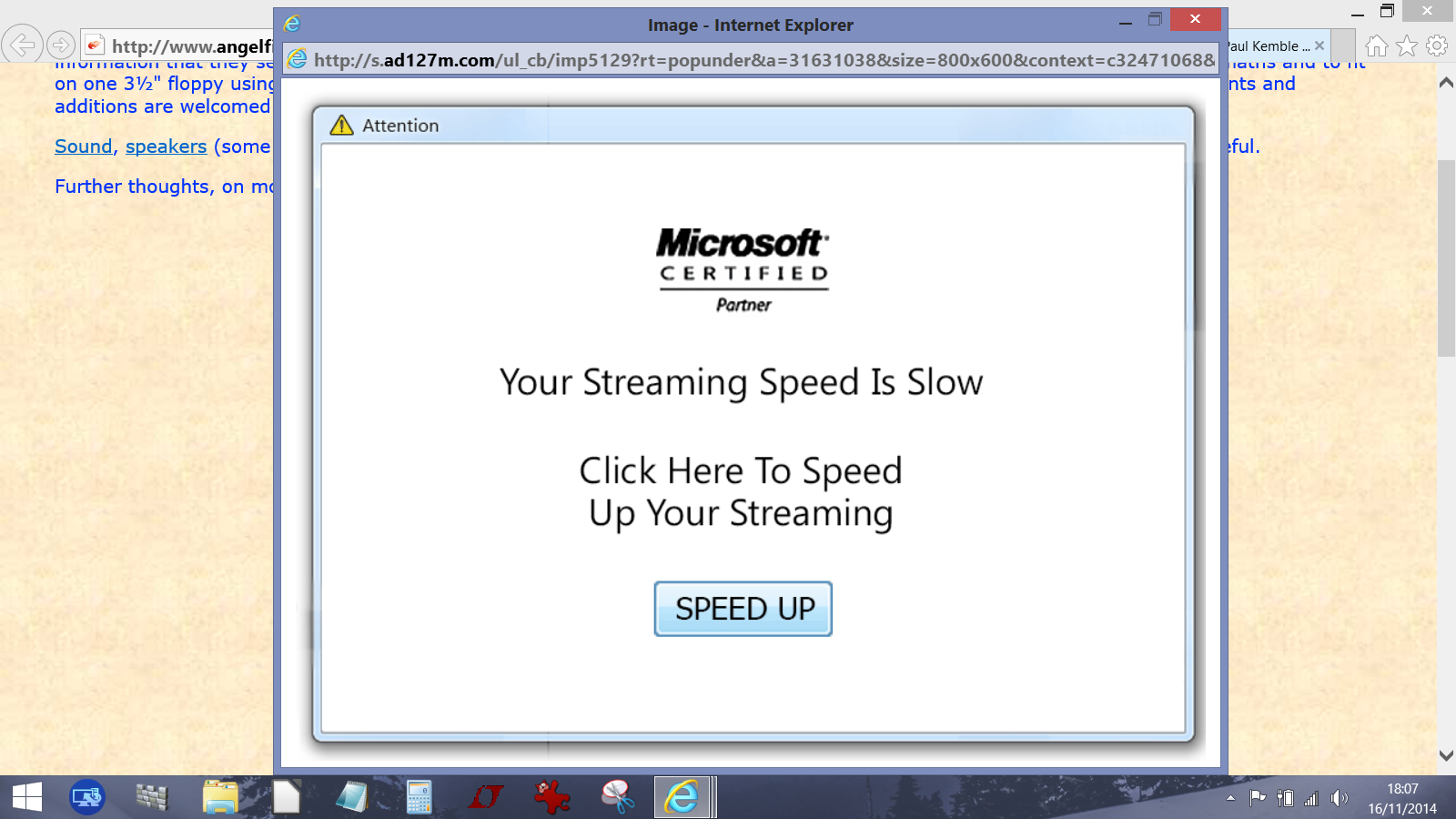

Hmm...you mean my link Mooly? Perhaps that part of of the spam doesn't travel to Oz as I can log in on another PC also, without getting that sort of message but of course, Angelfire is a massive spam generator - I guess they keep only the best for the the home crowd!😀
This link should divert people to the registration process which may be needed at Hifiengine. Apolgies to any who suffered that link's problems.

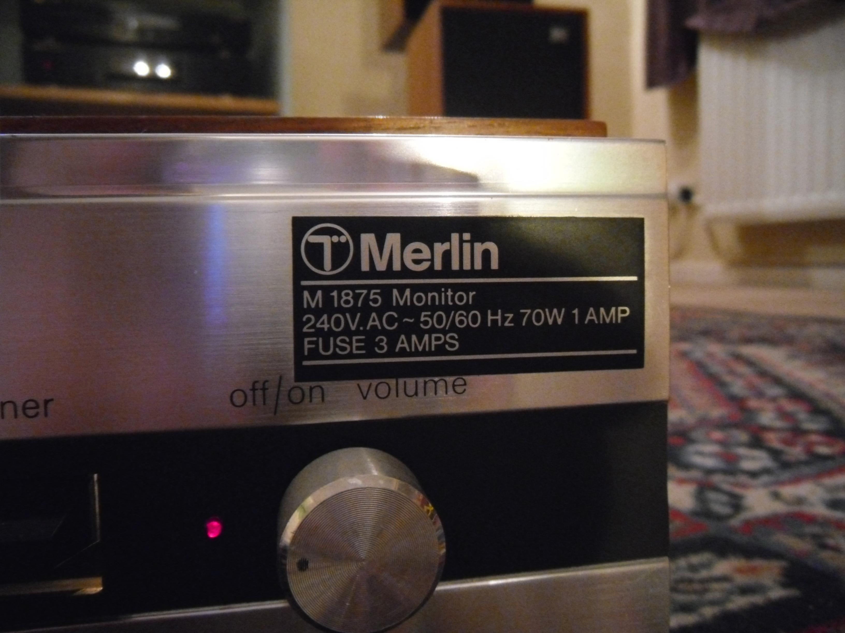

The badge has the T symbol of British Telecom from the 1980's ? Maybe previously owned by an employee... who knows 🙂
