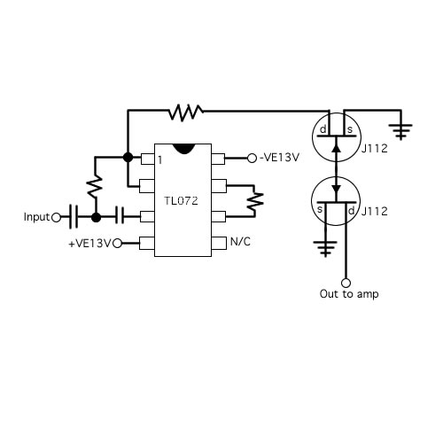

Okay I have drawn out the schematic for the first part of the input section, which is a start. Past there things get pretty complex. I only have limited test tools, limited to a couple of multimeters and an audio probe to listen to various points in the circuit etc.
Could a fault in either of the two transistors or the intro opamp cause a fault like the one I mentioned? It is a violent distortion, and is much higher in volume than the original audio signal prior to the onset of it distorting. The transistor configuration looks odd to me, I'm pretty sure I double checked when I made my notes, but I will check again tomorrow when I go back to the workshop.

Is this a chipamp or discrete amplifier circuit? If it is evidently a fault in the amplifier and not the preamp/filter circuitry, then there may not be a lot of options for chipamp faults.
OTOH, with discrete circuitry, you may find plenty of faulty components affecting stability such as caps, semis or soldering around the feedback circuit which may be causing this. A pulsing loud noise as you describe is usually called motorboating because of the similarity to a submerged exhaust pipe noise. It is caused by overcoupling of output to input of the amplifier or even the whole circuit, by wiring, component or ageing faults. Since you may believe it is heat related, it could still be any of these.
The circuit of the opamp/Jfet switch appears to isolate the amp when signal is not present. Is there more to it at the gates? I would bypass this Jfet pair or the buffer as well if possible and see if the trouble persists. Unfortunately, I haven't seen these yet so I can't give specific assistance or locate service details.l
