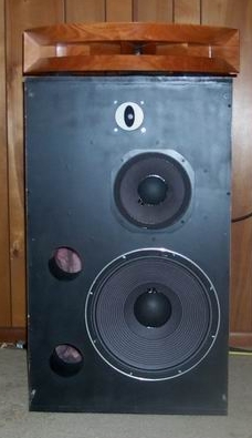

Old style 3-way, something like this, but with only one 15":Which model of the Westlake are you considering?

I couldn’t find a model that use just one 15”...😕 In any case, by using all different drivers (even as good as they are), it may not have much to do with Westlake any more, so you can do pretty much whatever you like with the layout and the driver configurations.Old style 3-way, something like this, but with only one 15
The Westlake horn shown is a 140° diffraction horn, and is best matched with a slot tweeter with similar dispersion Beyma CP21, JBL 2405/077, TAD ET703, etc.

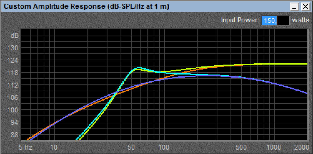

Gentleman's, I was made some mistake, sorry: I can buy HLS-3806-16, not HLS-38UL. It's 23 - 2K and this wonderful, but Qts = 0.12... Here's info: http://www.muehlbauer.mobi/HLS-3806_SPEC.pdf
Hmm... Made some calculation in BassBox.
[image deleted]
Blue and turquoise is 2335h, orange and green is TOA. Box = 220 litres. Blue and orange - closed box, turquoise and green - vented, two ports 160mm dia / 32mm length.
Looked similar!
Looked similar!
