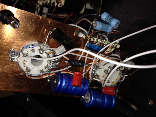

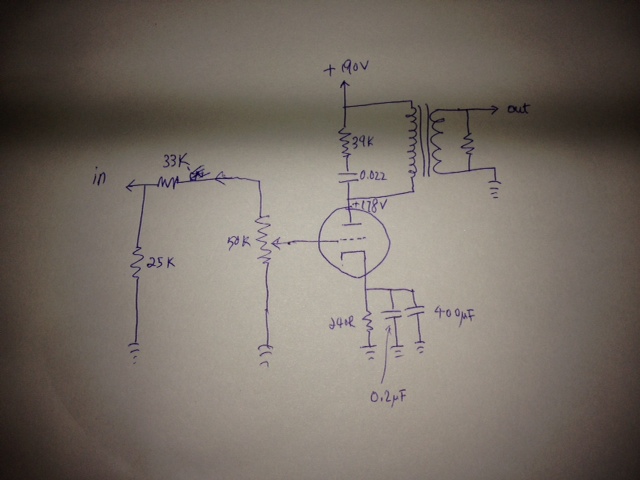

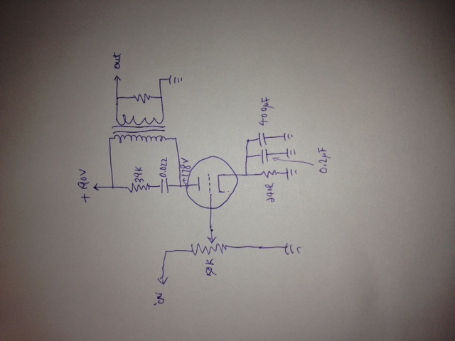

I bought a western 437A preamp from a DIYer that sounds excellent. Recently, I installed a low noise regulator and it is even much better than ever. However, there is one problem - the gain is too high that I can hardly turn the volume knob to 9 o'clock position. The DIYer said this is the best set up he has and it is not possible to reduce the gain by not affecting the sound quality. I traced the circuit as follows and would like to know is there any way to lower the gain but maintain the same sound quality?
