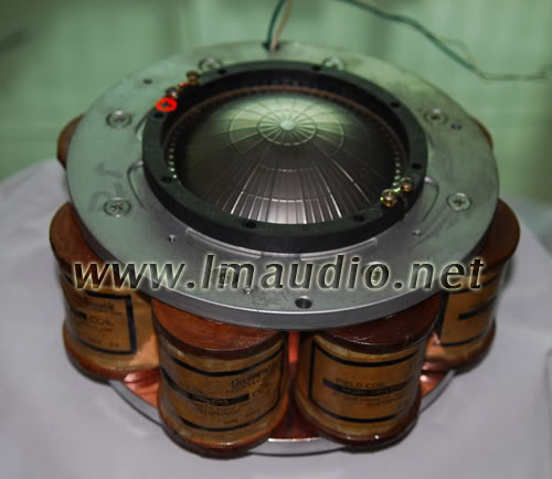

To kick it off here are some random pix from around the web of the 555 and related products:

actually the static pictures show a lot about the design and construction. You could build one with just those pictures, if you had some background knowledge.
The real problem in building one DIY is not the dimensions or the basic design, since the basic design is in the patent... something to think about here. 😀

fwiw the 3rd picture is a WE but not a 555...
The diaphragm looks like the bottom of a pop can, apart from the tangential ribs for a surround. Perhaps a thin flat rubber disk, or even a standard spider, could serve as a surround. Use the pop can sides as a voice coil former.
I think the first and fourth are 555 and the other 2 are more modern. If you want to get to the sound of a 15a you need to get the operating range down to the point of being useful in a full range horn. Low resonance and high Excursion will be the greatest challenge.
Line drawings of the 555 show the reversing sphere cross section and simple phase plug, like the first and fourth picture.
the second one is a Line Magnetics driver, probably a clone of the later WE594 (do I have the number right?) and the third one is a WE594 showing the phase plug and the field coil.
