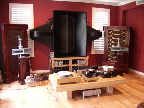

Here is an unrelated ad by Timbernation on Audiogon with a 16A in the background.
http://cgi.audiogon.com/cgi-bin/auc.pl?anlgtabl&1238722666

I dunno, Aldo says they have decent seperation, but you do have to use the 2 spread tweeters(see photo) to get it. Seems hard to imagine....

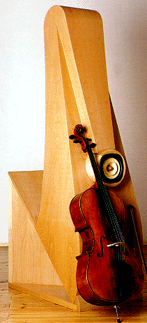

Actually, dual purpose. First purely academic, figure out how to design and build an exponential folded horn. The WE designs have a very gentle rounded shape vs modern horns with tighter folds for space savings. See the attached Carfrae Big Horn picture - unfortunately, Carfrae is out of business.
Second, to build a scaled version of the WE16A with a high-efficiency full-range driver (picture something similar to the Nelson Pass Klein Horn).
