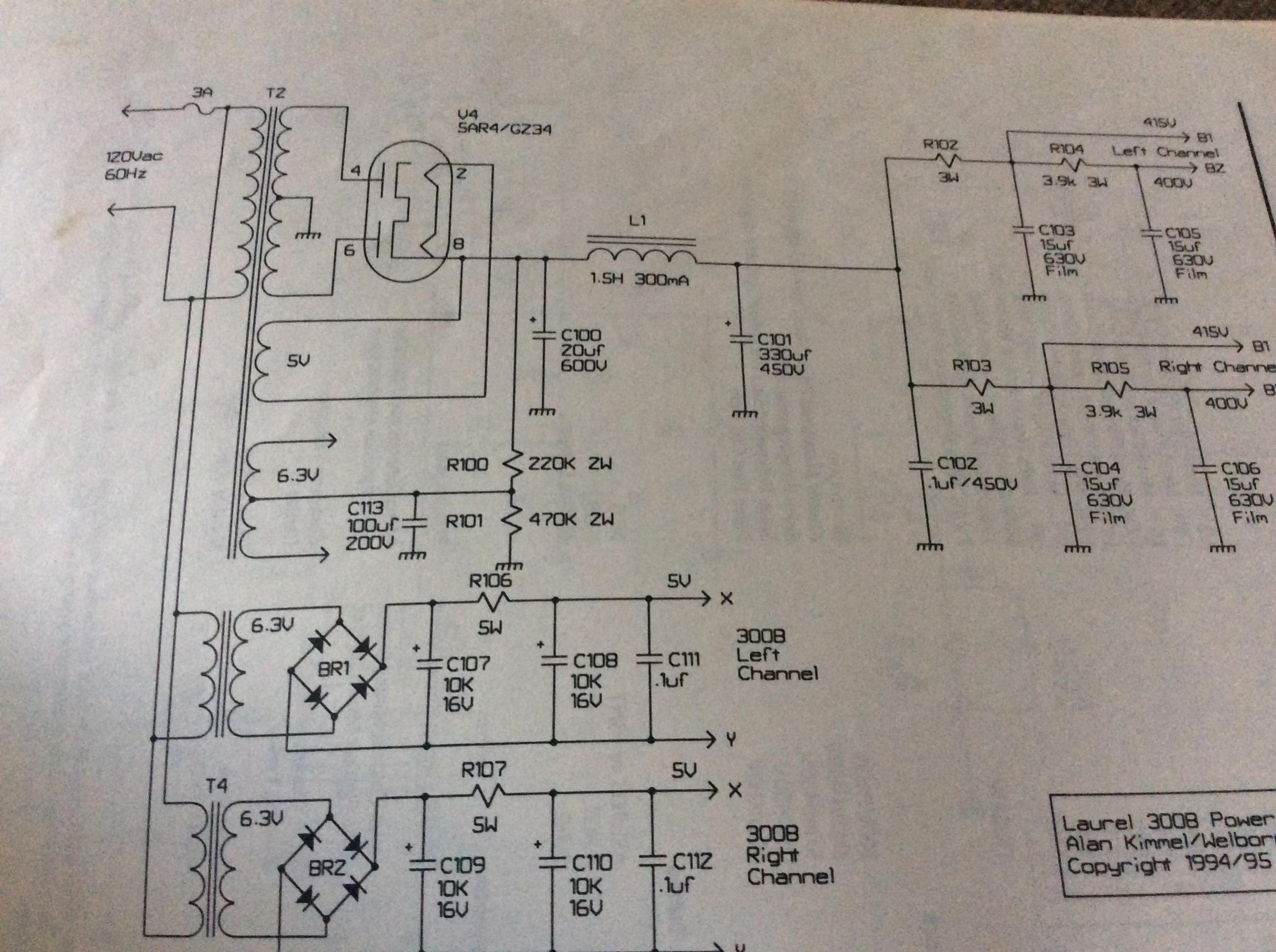

The Welborne DRD amplifiers were DC coupled from driver tube plate to output tube grid. The DRD are 2 tube amplifiers. The B+ is medium to high, because the DRD design has lots of drop in the output tubes self bias resistor. That voltage across the self bias resistor is connected to the driver tube's plate choke. The output tube's self bias resistor's voltage drop has to be large enough to run the B+ required by the driver tube plate. The driver choke has a fairly low DCR, so the B+ drop is less than if a plate load resistor was used. There were 3 Welborne DRD amplifiers, a 45, a 2A3, and a 300B version.
The 2 stage Loftin White 2A3 amplifier (also DC coupled) has to have medium to large B+ because the output tube self bias has to run the driver tube. But the voltage needs to be even larger, because the driver tube plate load resistor has a larger drop than the plate load choke DCR of the DRD amps.
The power supply schematic in post #9 on the right is for the Welborne model Laurel amplifier, a 3 tube 300B amplifier. It is not a DRD amplifier power supply (look on the far lower right, you will see 'Laurel').
I met Ron Welborne at the early VSAC conferences in Silverdale Washington. I also met Jack Eliano of Electra-Print Audio (and have done business with him a number of times). They collaborated on the DRD amplifiers, but I do not know how many original and how many spinoff designs there may be.

deafbykhorns,
1. Right, the Electra Print link I put on post #2 with the DRD schematic says: 90mA.
2. Be careful when using the Laurel power supply schematic. The electrolytic and the plastic caps that immediately follow the choke are only rated for 450V.
Using a transformer that has a 450 0 450V secondary will apply 636 Volts peak to the rectifier tube. Assuming a 50 Volt drop in the rectifier, that will be about 586 volts on those 450V capacitors. And all the other capacitors are only rated at 630V. If the rectifier warms up earlier than the other tubes, or if an output tube dies, all the 630V caps are going to be taken out too.
