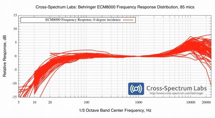

With all that said, get to know your mic curve. It will be fine up to some frequency then will rise in a certain way. If it concerns you, you might be able to find a generic calibration file, or make your own. You might compare the result to a known measurement, like a common tweeter on a large baffle, like the manufacturer curve.
Here is an example of the ECM8000 (many mics response plotted together), as it uses the same Panasonic IIRC.
