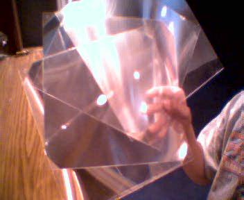

Ok I was bored today so I got my ohp out that I bought for $20 on ebay out and decided to take it apart. Strangest thing happened when I got to the fresnel. It wasn't easy to rip out in the first place but then when it came out it fell in to 4 different sheets. This wasn't like any fresnel I had ever seen in my life. It didnt have ring it had lines going straight in diferent directions on every sheet. The ohp was a super old 3M 213 model but the fresnel is what scared the hell out of me when it fell in to 4 different sheets. Does anyone have an have ohp like thiss or does anyone know of any fresnels like this? It's hilarious and strange.

The Fresnels you are talking about are not actally fresnels, they are Lenticulars commonly used now adays for a rptv screen.
